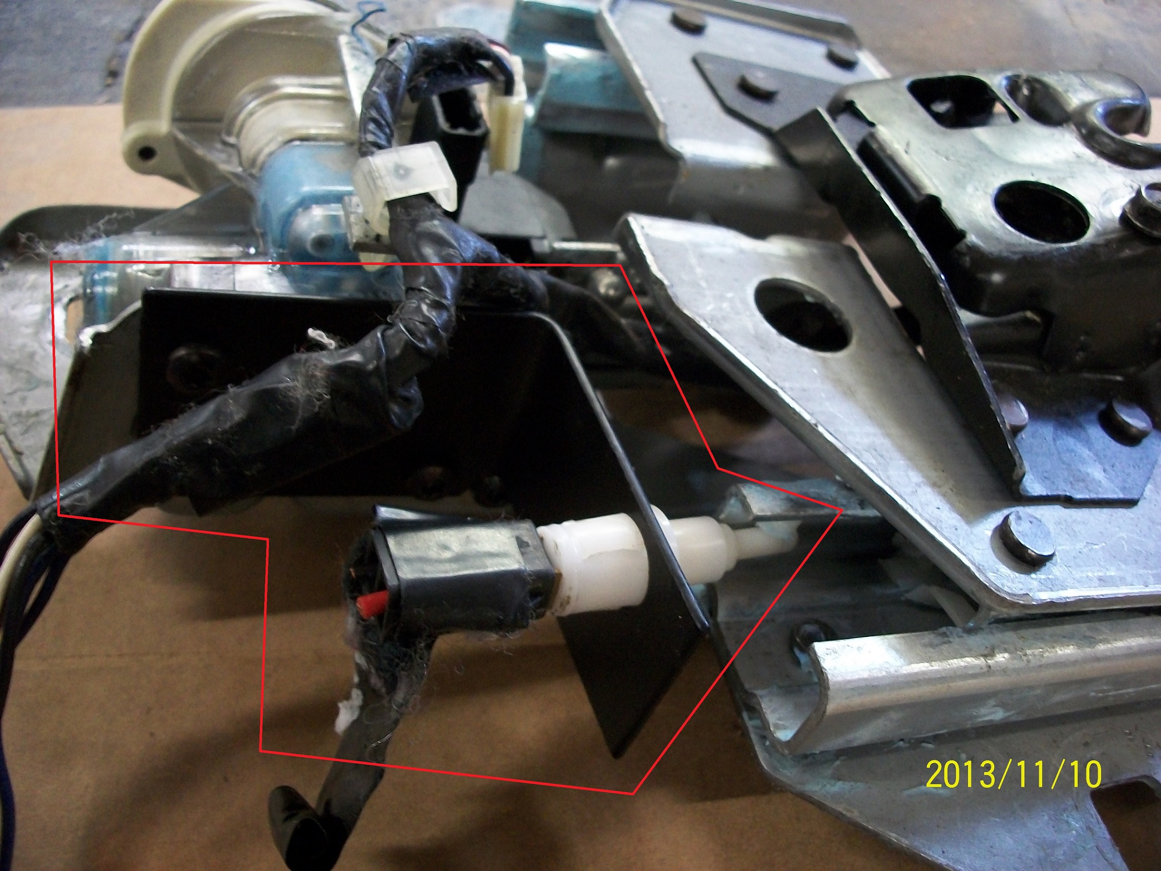

So I FINALLY got around to working on this today. I got a hatch motor rebuild kit from Lon and TDS, but I'm not sure what's going on with my assembly.
When I got the car, it had a killer vintage alarm system, complete with ignition interlock (which I promptly had professionally removed). Could the thing highlighted in red be part of that alarm? I think it was keeping my hatch from closing completely. The white thing connected to the black bracket is a toggle stitch of some sort, and the bracket fits the motor assemble perfectly. It's very nicely done, but I don't think its factory. The wires were already cut, so it's not doing anything. There is no mention of this part in Lon's rebuild instructions, so it will be omitted when I reinstall.
Thoughts?

That plunger switch is what prevents the tonneau cover solenoids from popping while the trunk is open.I just put one on my hatch pull down and now my solenoids actually pop when you push the switch

Interesting. So it's an ASC part from the conversion. Not sure why my wire is cut; I could not find the rest of the wire anywhere. But my tonneau release button works as it should, so I'm gonna leave well enough alone.
