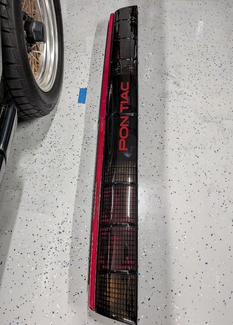

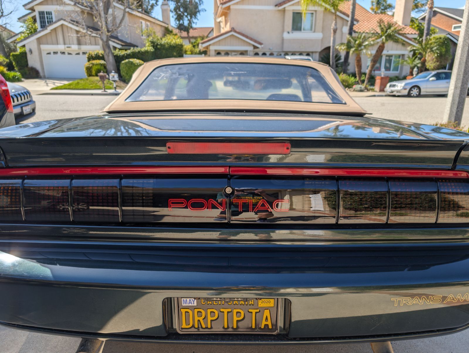

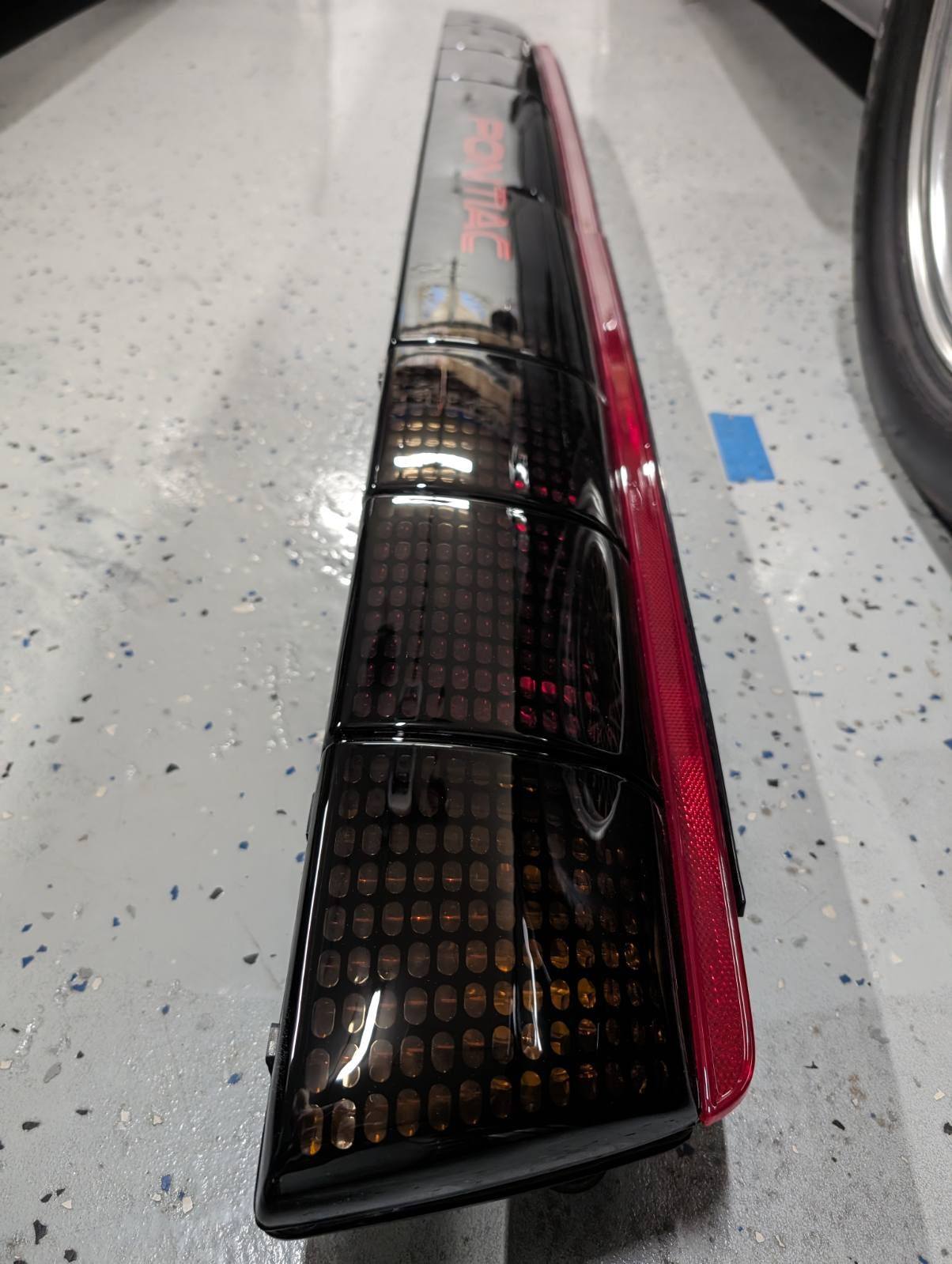

Car has been PNO for a few years now. Going to smog it and register it soon, but have to wait till mid-May. My understanding from what I read on the DMV website, if I register it before the registration renewal date then I have to pay for the entire year (last year) AND the next year. Their logic is that if the car is driven at all during the registration year then you have to pay for that whole year. So if I drive it before May 17th, then I have to pay for the entire previous year. So at this point I'm just going to take care of minor cosmetic stuff until I can get it registered.
Last week I took the tail lights off and cleaned behind them. Then took them to get a tint spray on them. Was going to get them wrapped, but my tint guy said that getting down between the lights would be difficult and would only last a couple years. He suggested that I get them sprayed instead. He was right. They came out great. What the shop did was buff the lights, spray a coat of clear, sprayed a mix of clear and black (tint), apply the stickers, and then another coat of clear to to help protect the paint and lettering from UV rays. I think they look amazing, but that's just my opinion. Judge for yourself.

The taillights do look great. I like your garage floor too. I've been wanting to do that, but my garage is 2000 sf, and it will be heck to clean and prep, but maybe one day I'll be motivated enough. More likely I'll do a design out of floor tiles, a section at a time.
You're right about CA. I had mine non-op for a couple of years long ago, and when I decided to take it out, I had to pay for the full current year, so if a new year is approaching, and you can wait, then wait. That said, I believe renewals can be done up to 3 months in advance, so maybe that would be a loophole for getting it out now without having to pay for 23-24 too. It would be worth checking into. I think smog certificates are also valid for up to 3 months prior to registering the car too, so you can probably get that done now, even if you can't register it until May. If, for some reason, it doesn't pass, then at least you still have time to work on it before the registration date.
Those tail lights do look great!
Curious, did you have any delamination/degredation internally, and how did you correct that?

Yes, I did have some delamination on one side. It didn't remove or correct the delam, but it does help hide it. If you zoom in on one of the pictures you can see it above the letter "C". But in person it's not noticeable like it was unless you're looking for it. If you went darker it would probably hide it, but I didn't want to go too dark. I think where I got the color it still retains the character of the original design.

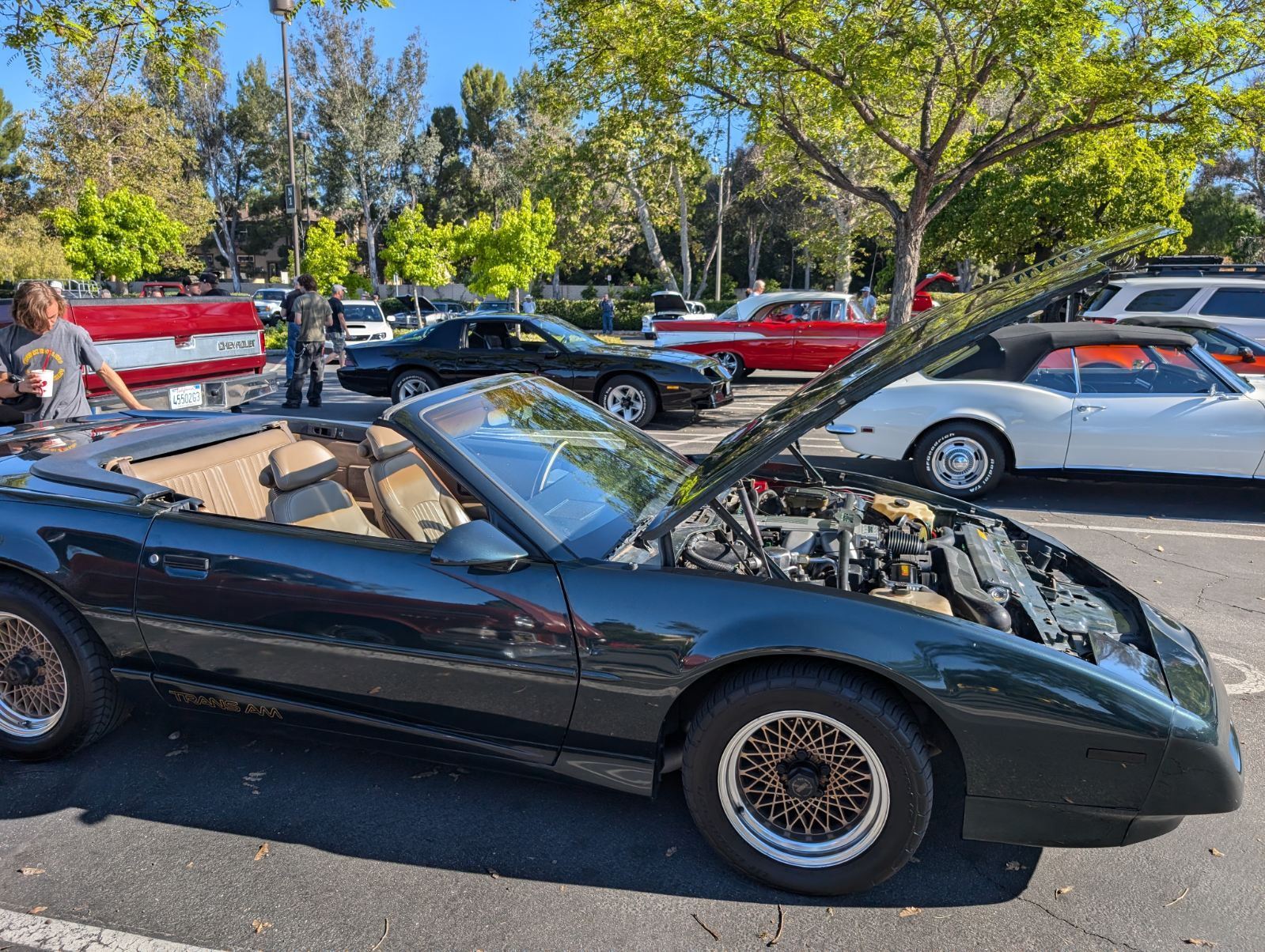

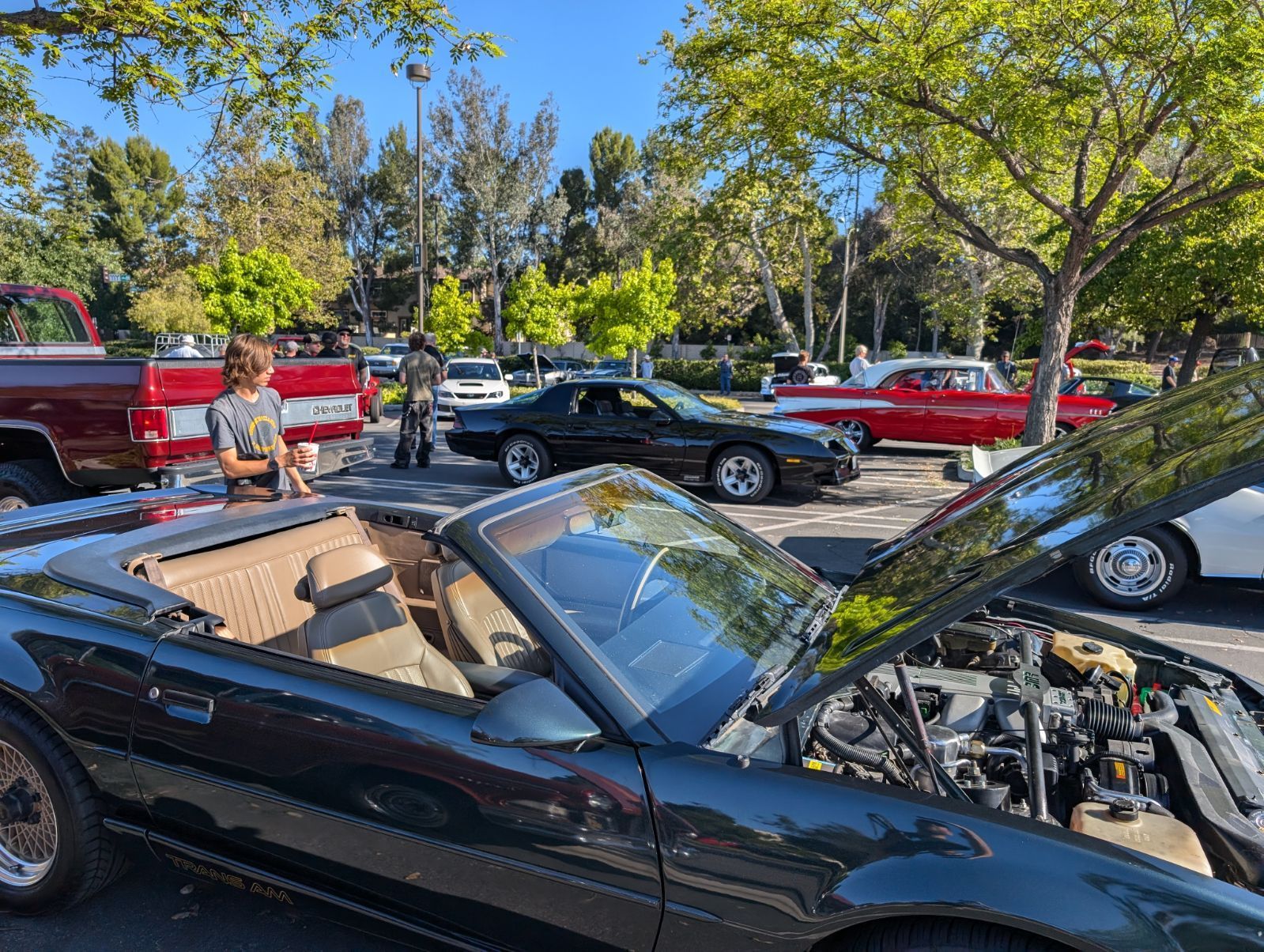

Was able to take it to the local Cars & Coffee with my son. There was one other thirdgen there briefly.

Car looks great. Are those seats original leather?

That TA Vert would look so much better , with it;s hood closed!

I was 50/50 on whether to open the hood or close it. The lines of the car look great when the hood it closed, but the engine bay looks good as well. Plus, must people have the hoods up, and I was the only TPI car there.

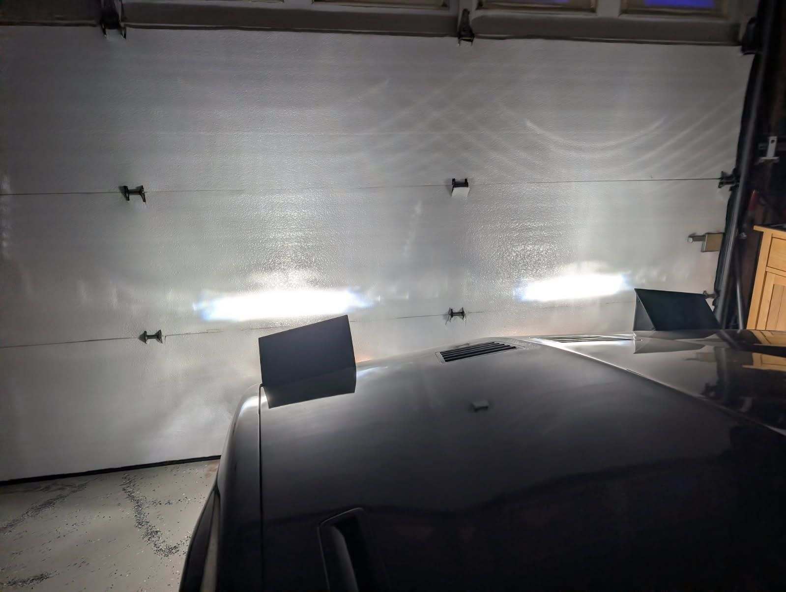

Replaced the stock replacement headlights with a pair of Holley Retrobrights. Yes, they were pricey but I'm pretty happy with them. The road pic is with the low beams. I have to fix my dimmer switch before I can get some hi-beam pics.

Bright! I went to an older thread to see your Morimoto pictures. These look brighter than the Morimotos, but not as wide. But this picture is on a 4-lane road, whereas the Morimotos were on a 2-lane road, so maybe these are as wide. Both are way better than stock, and it's cool that with two cars you can have both brands.

Are these LED lamps?
Yes. They are LED headlights. They fit in the '91-92 headlight bucket without any modifications.
