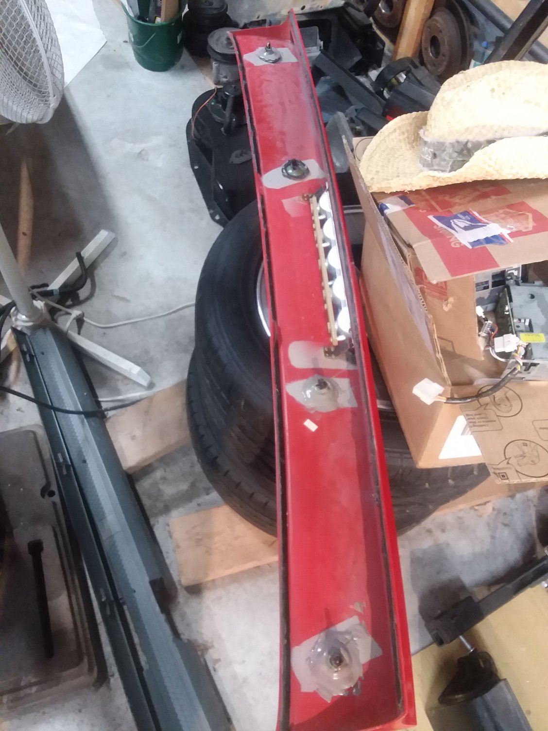

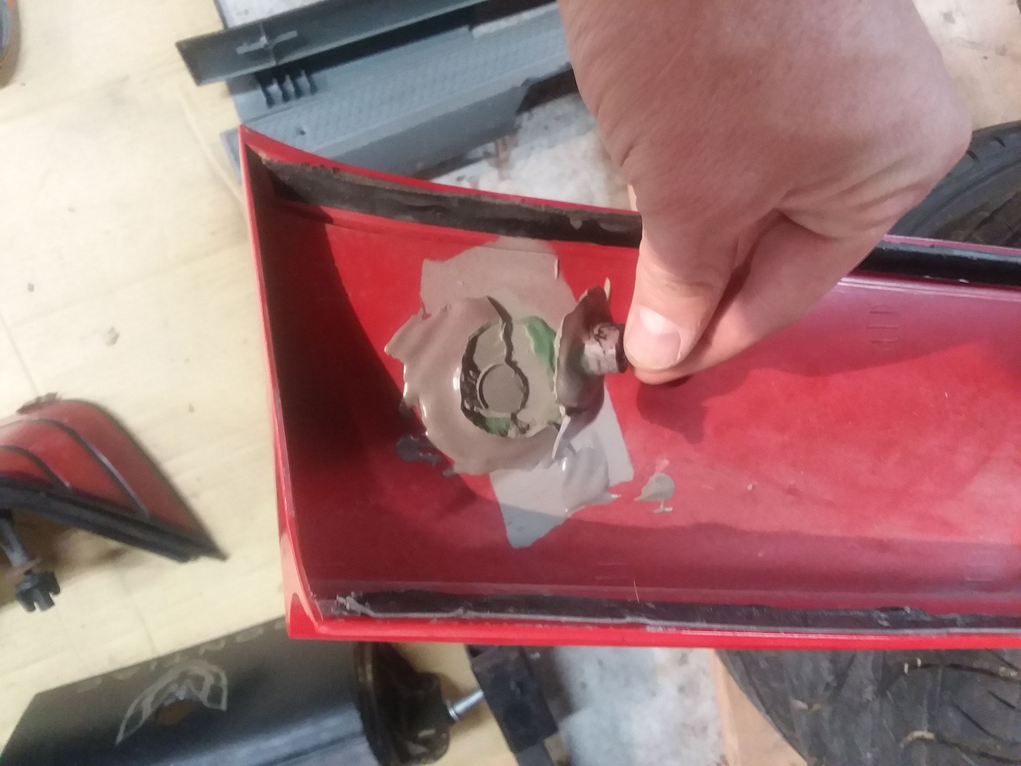

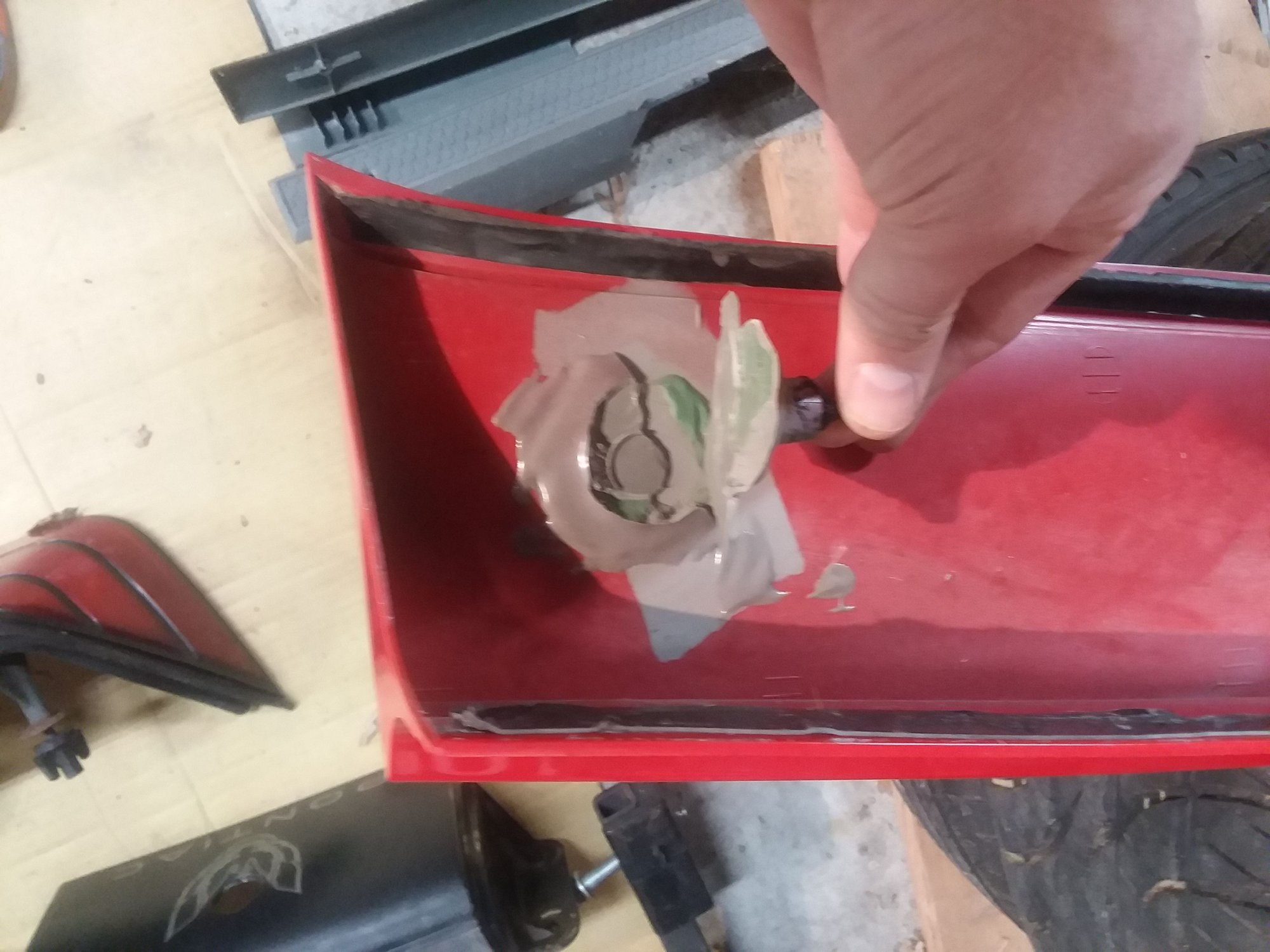

I removed my vert spoiler for the first time since I've owned it, and found a surprise waiting for me. It's been off before. And repaired.
Two of the repaired studs broke off.
What should I use to secure these back in place? The bolts line up nice, so seems like an easy repair, just looking for the right product. And what prep?
Maybe this?
Lowes - JB Weld Epoxy?
Thanks!

I think your two best options would be to use a flexible bumper repair kit or that type of adhesive from one OR to replace that gasket on the front and back of the spoiler with good 3M double sided automotive mounting tape. Yes the tape REALLY works. I had a SN95 Mustang years ago that I put those side scoop covers on and they called for using the 3M tape. I was sure that they would fly off on the highway but they held for years at highway speeds.
I would not use an epoxy unless it was panel bond but that's $60 for the two tubes so pricey for the relatively small amount you'd use.

I had a hell of a time getting that double-sided tape off! I agree, it really holds well. That's how I broke the studs - didn't know the tape was there, and was pushing from the underside. I plan on using that method again. I'd just like to also get the studs secure.

I used flexible bumper repair as well.Worked great, i noticed base on the studs is tapered.Wider at the bottom.This prevents it from slipping out, but you have to build the adhesive high enough around the base.One of mine was spinning in place and would not come off. Thats how a noticed its tapered.So i decided to cut teeth around the base before re-installing.This way if it ever breaks loose again hopefully it wont spin, allowing the nut to come off.
