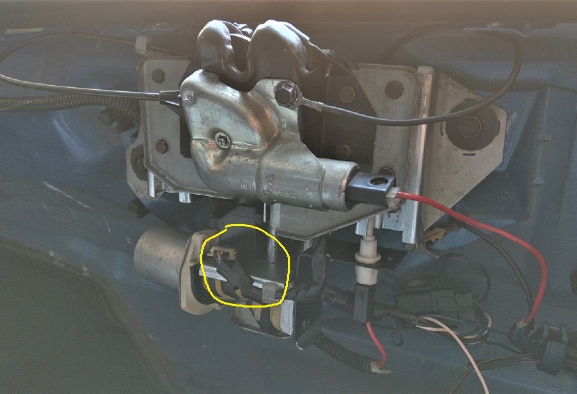

Hatch pull down is all the way back in like "A frightened turtle!" will not engage the hook in the decklid - is there a driveway solution to reset this?

As for the trunk pulldown, Check around the circled area. There's a switch down there that engages pull up when the trunk is popped. Check for loose screws that hold the motor on, 2-3, 10/11mm.

Post script: Both working now. Top pull down was just the weak battery that needed to sit overnight on the charger. Hatch pull took some figgering, but I could see the white plastic plunger was out of position, so I re-seated it. Snapped the pawl closed and after a cycle or two - works like it's supposed to.
