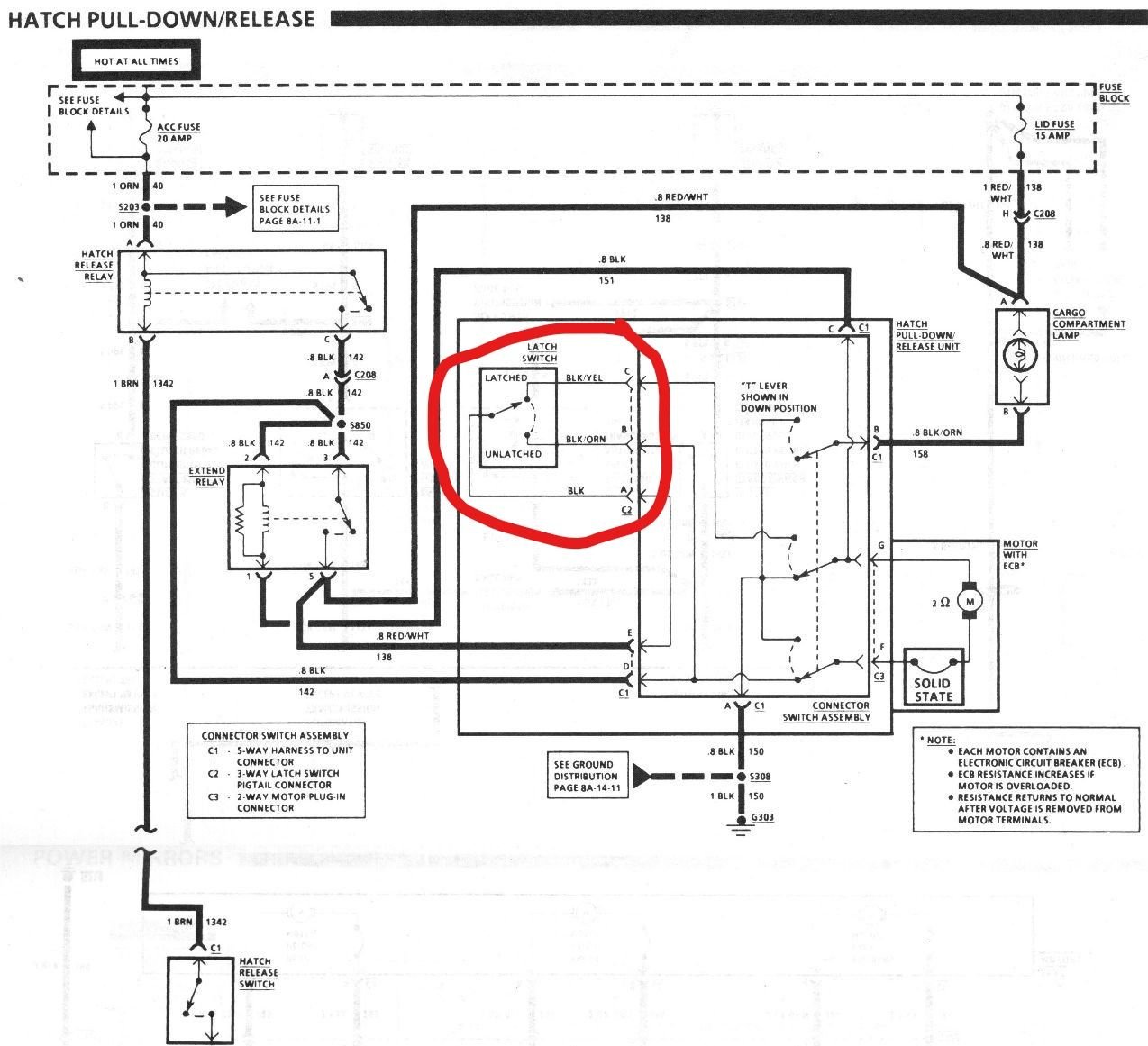

There's multiple reasons for the hatch pull down to stop working and when troubleshooting the hatch pull down motor assembly it's a good idea to check the wiring in it's entirety to rule out it's not the electrical system that's failed, something simple as a loose or broken ground wire will keep the system from working.
Is the hatch motor assembly in the up/hatch open postion or the down/closed postion?
When closing the hatch and the hatch motor is up/hatch open postion there's a three wire switch that the hatch striker bar pushes, red arrow. Without closing the hatch, using a screw driver or a pen/pencil, push down on the striker switch, called the latch switch on the drawing below. If the motor does not start to cycle the hatch motor assembly down then there's a chance the striker switch/latch switch is bad.
Mine is stuck in the up/open position. I pushed on that switch earlier with a screw driver. Nothing happens. I don't see any loose wires though. I already ordered a motor. I can order that switch too. Is there a part number for it?

There are no available new replacements for that switch, your options are to fix what you have or find a good used switch. To replace the motor the entire assembly needs to be disassembled which will give you an opportunity to have easier access to the latch switch and the “T” switch these need to be checked or putting in a new motor isn’t going to get you anywhere. Also check the relay, does your cargo light come on with the hatch open?

Finally got back to working on this. I checked that 4 pronged connector that plugs into (I believe the reversing switch) by the motor. It has 12.5 volts just like the battery, so I assume that's fine. Anything else I should throw the multimeter on? Or just replace the motor at this point?
Ideally the whole electrical system needs to be checked not just a circuit or two, the reversing switch has two sets of movable and stationary contacts, one set could have continuity and the other not. Could be the set of contacts that supply power to the circuit that supplys power so the motor works in the other direction, You already bought the replacement motor and the whole assembly needs to come apart to replace that, then would be a good time to further inspect the reversing switch.
I don't remember have you checked the ACC fuse? The LID fuse must be good because you said the cargo light worked.

Life kept getting away outside of my car. I tested that pigtail it has voltage for both up down and continuity. I tried replacing the motor and it goes up but not down. I'm assuming that switch is bad. Problem is, I can't find one anywhere. It seems no one makes one anymore. What are my options? Is it easy to convert the car to a traditional latching?
