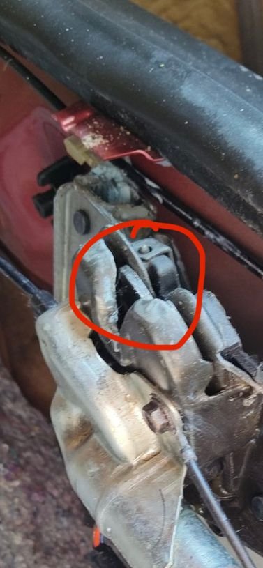

here is some images. Car is currently is storage and I'm hoping to move her out tomorrow where i can work at the Hatch.

Looks like it’s in the up position, assuming you have 12v going to the system when pushing down on the switch circled in red the whole assembly should immediately start its travel down, now that’s contingent on if the assembly isn’t in a severe bind mechanically.
Speaking of mechanical bind, 30 year old OEM grease I feel is the main issue with the pull down assemblies, at this point the OEM grease has the consistency of Play dough or clay, if everything was working and you had no issues it still would be a good idea to completely disassemble the pull down assembly to clean the OEM grease out and re-lubricate, I used Lithium grease, but anything is going to be better than what’s in the now.
Mechanical bind, I can see there appears to be at least two guides intact but what you can’t see could be totally broken up, if your disassembling the unit these should also be replaced
