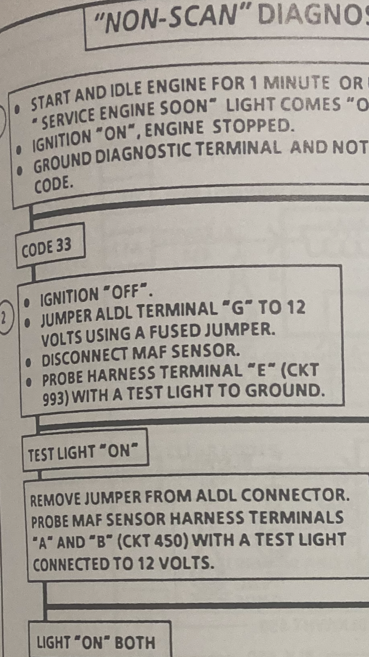

okay the reason that i need a 12v jumper is to hook up to my adla as the service manual says to make it easier to find the bad wire i should have causing a me to have a code so if any one could tell me how to make one that would be appreciated

Old thread but I just purchased a repair manual and I’m also trouble shooting code 33 and the manual says to jump 12v with a fused jumper. How exactly do it do that? Thank you

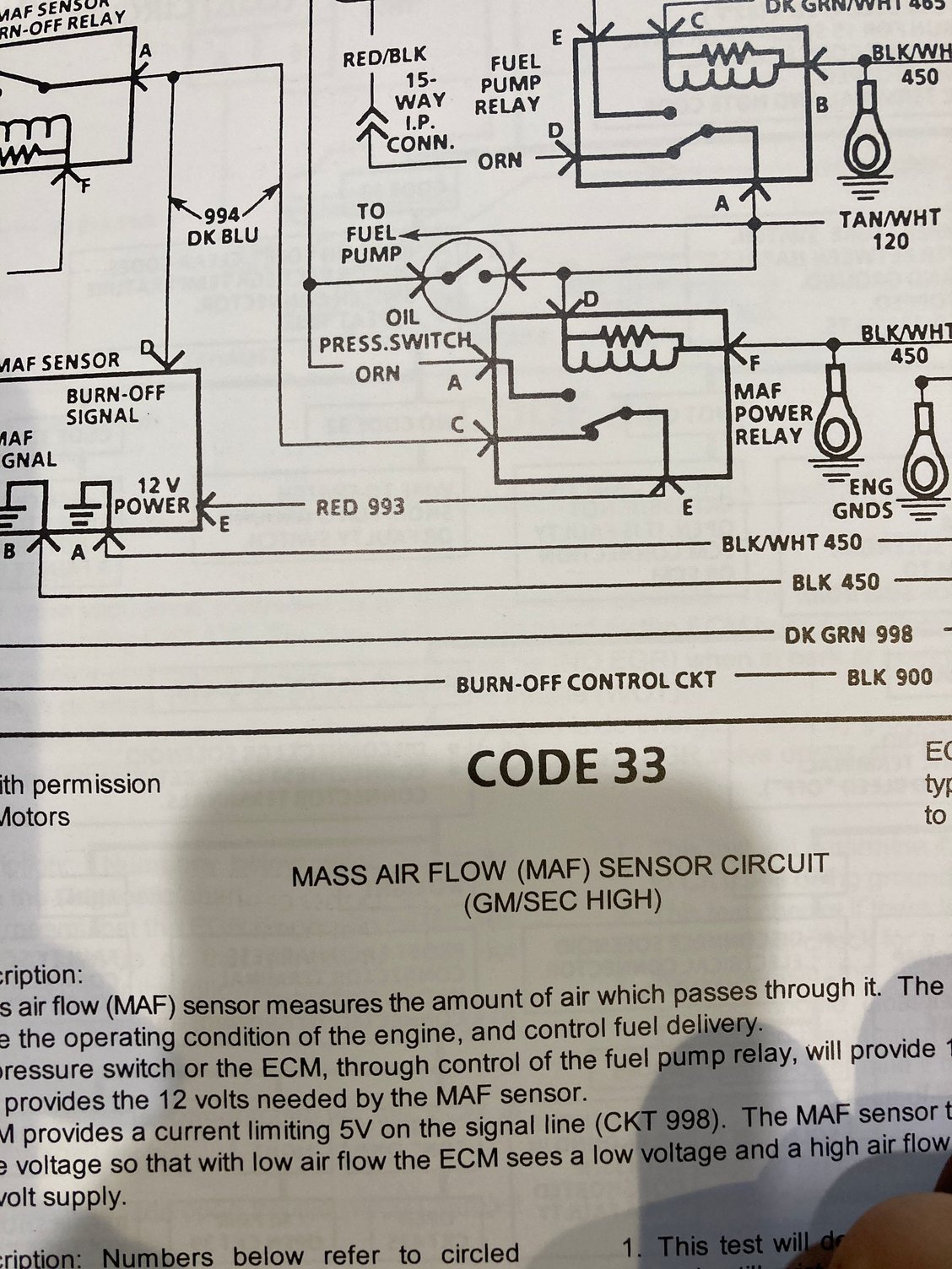

hey was up! Happy Friday! I purchased the manual you recommended and you know just still following the same codes after the new ECM lol. Now that I got the manual, it’s the lingo and the diagrams that I need help in now.

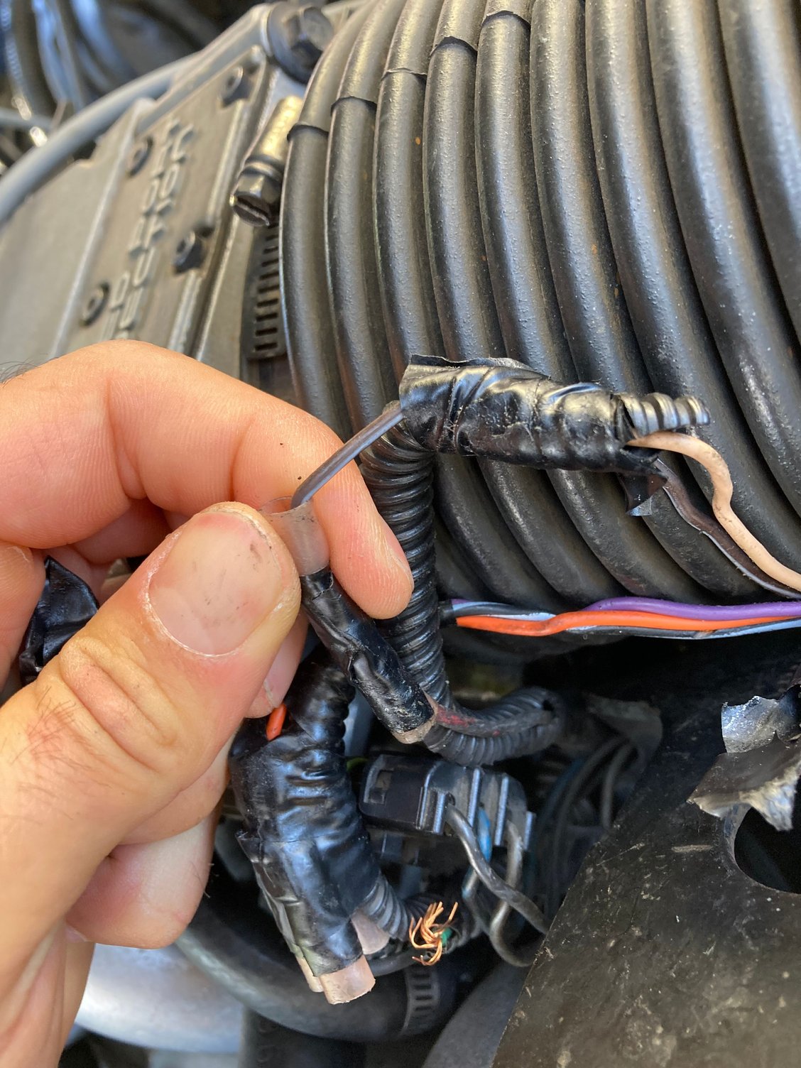

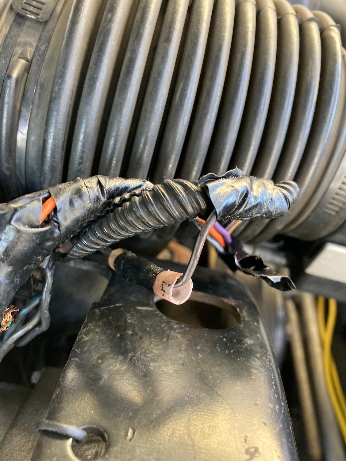

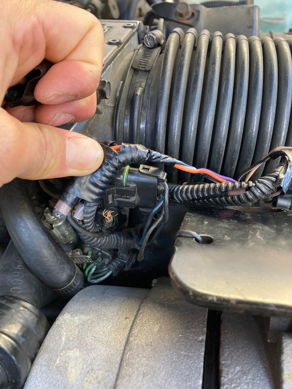

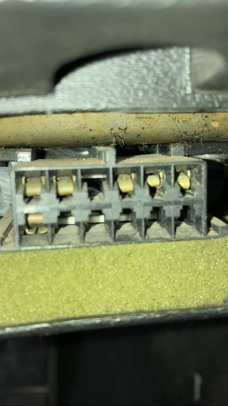

so looks like they changed the pig tail that’s why the new colors don’t match but the red 993 wire is now brown with the new pig tail. I might have a lot of ground and wiring issues and glad You recommended me the manual. I just need to know how to jump those 12v but not after I make sure all wires all all properly connected. You can see how horrible they are connected and the dark green 998 wasn’t even connected anymore

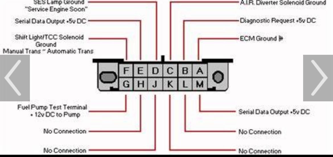

On your aldl you might not have a wire in G , G is fuel pump
was hoping the ecm was the problem solver

Oh geez they cobbled that together

I actually do have a wire on terminal G
