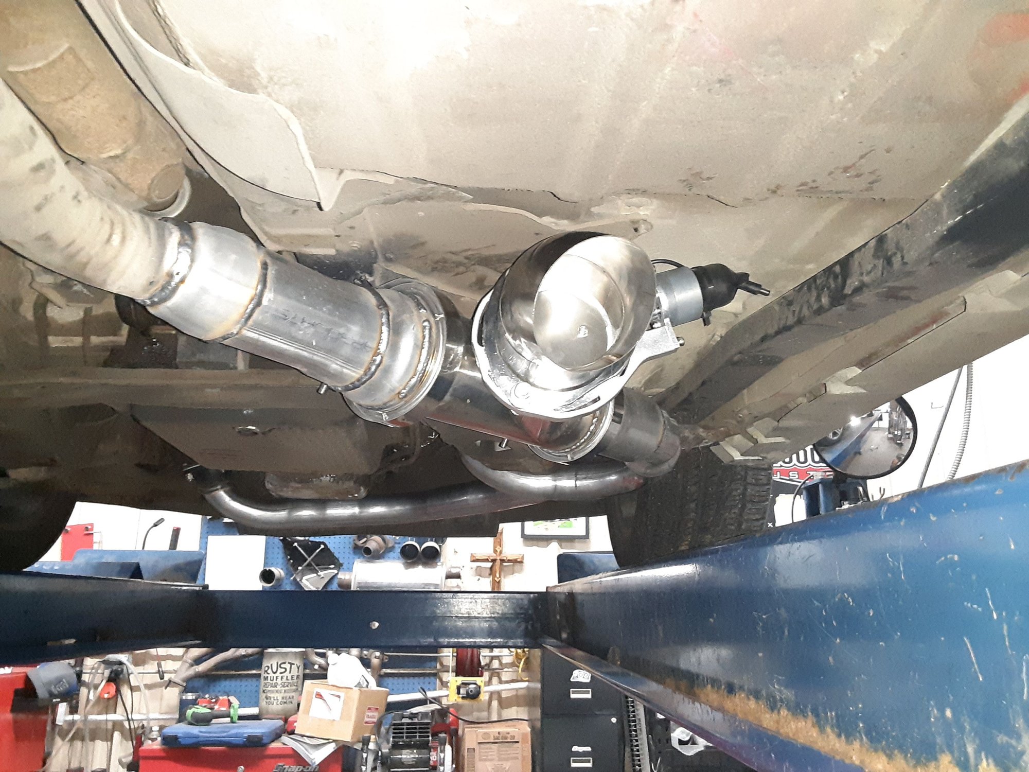

Whats up guys and gals? Havent been on in a while but ive made soo much progress on my '86 Z28. It now has a mildly built 400 sbc (509 block casting). The new 1/4 mile personal best is a 13.5 at 104mph!
Now onto my issue. I went down to a exhaust shop and had him make me a custom 2.5" Y-pipe with a 4" cutout and mate it up to my factory 2.25" "catback". He did a great job and everything but after I left and topped off the gas tank to make it home, the gauge needle jumped from full tank down to 1/4 tank before I even left the gas station parking lot and stayed there for most of the drive home (40ish miles). After about 15 miles it moved up to half tank, then after another 10 miles or so it moved to 3/4 tank. Now a day later its back to 1/4 tank but I know it's really close to being full. I'm not sure what happened but my fuel gauge is important when I get 13mpg on the highway lol.
Its a factory vin H car with the (now impossible to find) carbureted fuel sending unit that is 35 years old. Can anyone help shed some light on what could've happened? I just had the gas tank out like a month ago to lengthen the in-tank return line down to the bottom of the tank in preparation for my Holley Sniper Stealth EFI and am not looking forward to taking it back out.

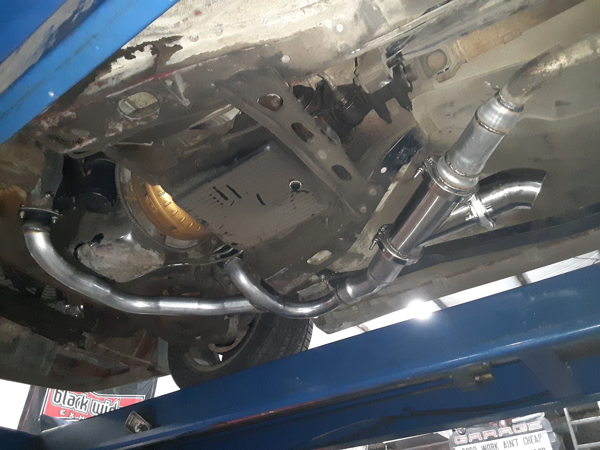

Here are a few pics from when the exhaust was finished
