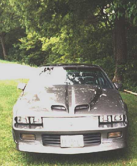

Hey- I had a 383 stroker (.30 over) and i blew it up, so i went .60 over on my new engine making it a 388 stroker(the block is a 81 4 bolt main). I have a 165 degree thermostat and my timing is set correctly. I am using the stock electric fan which runs constantly and a aftermarket 2 core jegs radiator, and a stock water pump. I am playing hell trying to keep this engine cool, with my old 383 i would run around 190 to 200 degrees with this new 388 i am running 240-260 when driving and about 210 at idle. Anyone have any ideas how i could keep it cooler?

Car looks great by the way.
