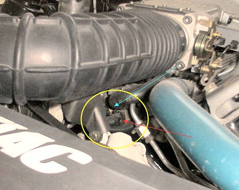

Old Jun 22, 2002 | 01:25 PM
deadbird's Avatar
Joined: Sep 2000
Posts: 6,775
Likes: 28
From: So.west IN
Car: 87 Formula/ 00 Xtreme
Engine: TPI 305/ v6
Axle/Gears: 3.08/ 3.23
9th injector sensor/timer (red arrow.. pink & tan wires.. later years don't have this) & directly next to it (couldn't quite get a pic of it..)
Coolant temp sensor (blue arrow). This is 100% non-gauge related. Most standard colors for the CTS wires are yellow & black.
