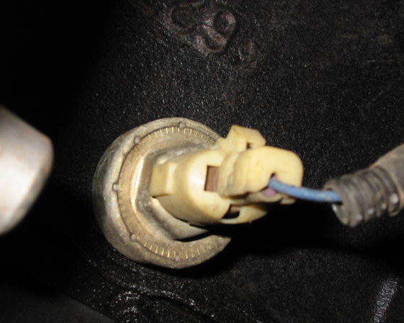

Here's a picture of my jet-fan switch installed on the passenger side of the engine. I don't know what that other sender unit is you're describing, I thought it could be the Knock sensor but that's also on the passenger side at least it is on my 91 RS.

I looked at my engine to where the fan switch is supposed to go as GKK's photo suggested(thanks for the photo). However, it seems absolutely impossible to get to it from up top. Can I get to it from below and how long does it normally take to install? Thanks
