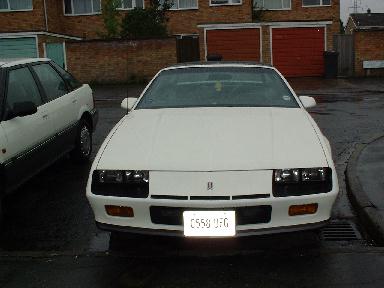

I have an 86 S.C. 305 4bbl and my temp guage sits just under the 1/4 mark all the time regardless of speed, even a quick 110 MPH blast down a deserted bypass (freeway) faild to budge it!
my fan does not kick in automaticly so when the temp guage reaches 1/4 in traffic i simply turn the A/C on and the fan kicks in.
the A/C does not work (needs re gas) so at least the switch does something usefull.
is there any chance an A/C re gas will cause my car to over heat? i've read some stories of cars getting hot with the A/C on, but they all seemed to be running a lot hotter to start with.
Attached Thumbnails What are normal op temps for 350 TPI?-chevrolet-camaro2vsmall.jpg

Transmission: 5 speed
Axle/Gears: 3.42's
That car looks good. The white camaro in the pic above.:rockon:
