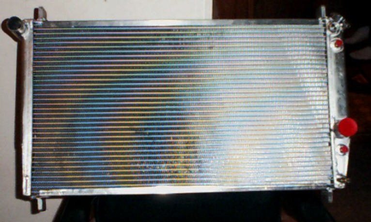

got my Be Cool in today
Got my Be Cool in today I bought the custom fit one for a auto.
Just thought everyone would like to see it. Got it from Summit for a wallet drainging $549.69. btw does anybody else have this one? There are 4 pieces on it sticking out, 2 on top 2 on bottom not sure why? (Look at the pic and you will see what I mean) Maybe I'll find out when I go to put it in.

looks nice, thats a lot of money though
looks like mounting areas for it!!
my stock replacement did not have them...

Looks "pimp"! Have you done the swap yet? Any difference in weight between the two? Temp? Just curious b/c when i get another $600 to throw around i would like to get a new radiator. Instead i got mine flushed and had the tanks replaced for $70, should do for now!

No I haven't done the swap yet but will be doing so this week. As for a weight difference I think there pretty equal or it may be a little lighter but not much. There both pretty light though. In the temp dept. it better help some if not then I'll be pissed and Be Cool will hear about it.

Yes it's finished, The "bolt in" style wasnt a bolt in for me though had to do some modiying to get it to clear the blower pulley. Have not ran the car with it in yet, car has been down for quite some time now getting numorus parts added. Should be up and running soon.

Hi,
I ordered and installed the big Griffin radiator for my 87 Iroc
and made sure it came with the heater hose connection on it
and from looking at yours don't see one. Just curious

Yep it's there just above tranny line!

Those tabs on yours sure would have been easier on mine
to fabricate mounts for support.
I had to get GM truck four core rubber saddles for the top
and the bottom because of the Griffins width. It all worked
out nice though and looks great especially after polishing
out the tanks.
