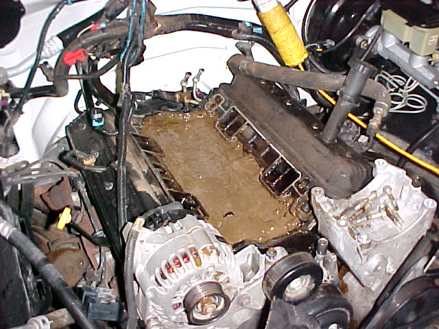

watch out! this can happen

bigals87z28,
Did a hippo take a dump in your lifter valley or something?

hehehe no... it was a zebra... but close..heheh nah... i got that pic off this site... its a 350 vortec truck engine... they guy wanted to know where his coolant was going... never checked his oil i guess... its that weekly maintance that prevents a stuff like that man... speakin of which... i gotta go check the trans fluid... i think i gotta leak in the pan or gasket... its drippin a little bit at a time..
