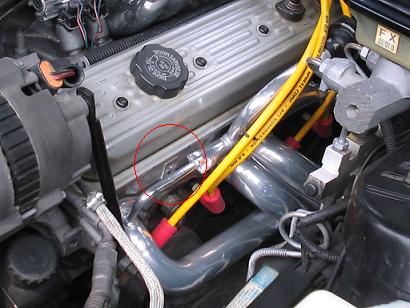

ok.....is this what your talking about??

another
Old Aug 10, 2003 | 08:03 AM
Cruzin Kaz's Avatar
Posts: 3,331
From: Welland, Ontario, Canada
Car: 85 Monte Carlo SS...
Engine: T.P.I L98.
Transmission: TH350
Axle/Gears: 3:73 Posi
Yeap..that be the one. Well the circle in your second pic is a bit off, but it is the sensor right between the two plug wire boots.
