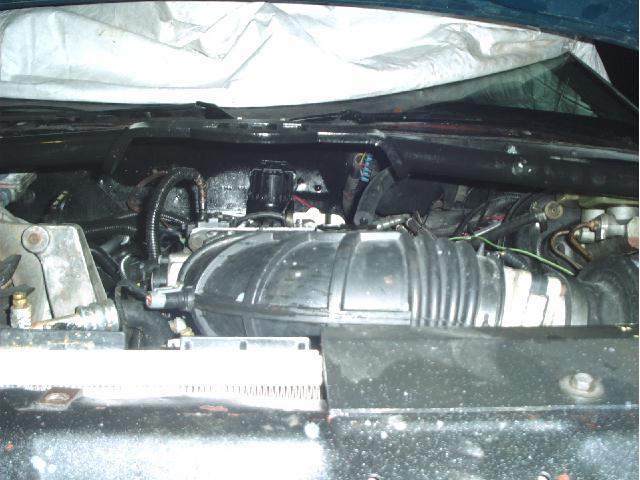

Old Sep 18, 2003 | 08:42 PM
Z28ricer's Avatar
Posts: 4,149
From: Tampa, FL, USA
Car: 93 240SX
Engine: LQ9
Axle/Gears: 3.54 R200 IRS
You can see it here on the left by the alt fan.
Old Sep 18, 2003 | 10:09 PM
sinner's Avatar
Joined: Jun 2000
Posts: 312
From: umatilla county, or.
Car: 1992 Camaro Z28
Engine: 1995 Camaro LT1
so from there how does it get to the heater core?
is that a wrecking yard item?
