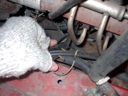

I just took some pics. I have done searches but found no pics of the fan switch relay. Is this the Fan Switch Relay???? I have read a few post saying that it is in the corner where the firewall and fender meet and it has 4 (four wires coming out of it).
