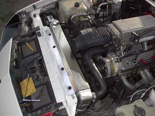

Here's a few shots, they're not "bolt in" by any means but they will work and definately worth the effort!!!
Excuse the mess, did an oil change this morning and still waiting for my overnight part from Jegs to fix the water inlet problem-part where the radiator caps screws onto the unit on the intake developed a hair line crack and every time I 'd shut the car down water sould seep out around the filler neck New one is fully welded around the outside of the filler neck....which it should've been in the first place!!!
