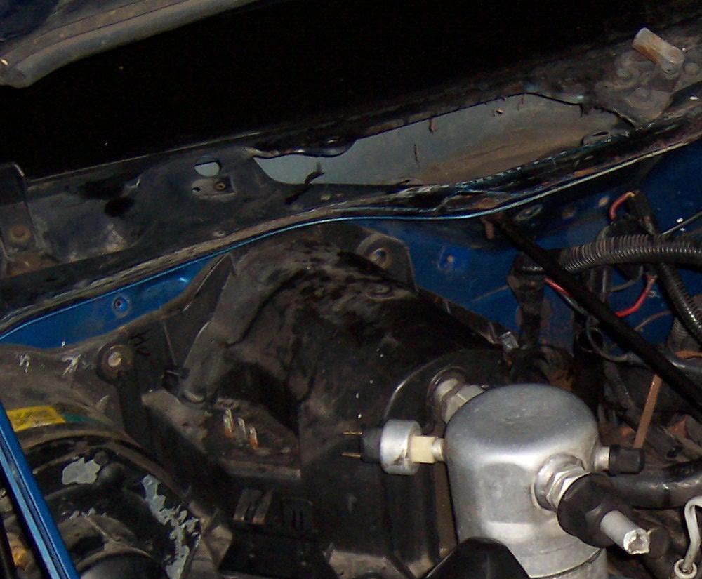

how do i remove this silver canister????
how do i get this out? anything technical i need to know or just unbolt everything and yank it? thanks:hail:

Just remove the line fittings and maybe one bracket and lift it out. Don't forget to remove the old orifice from the rear fitting.

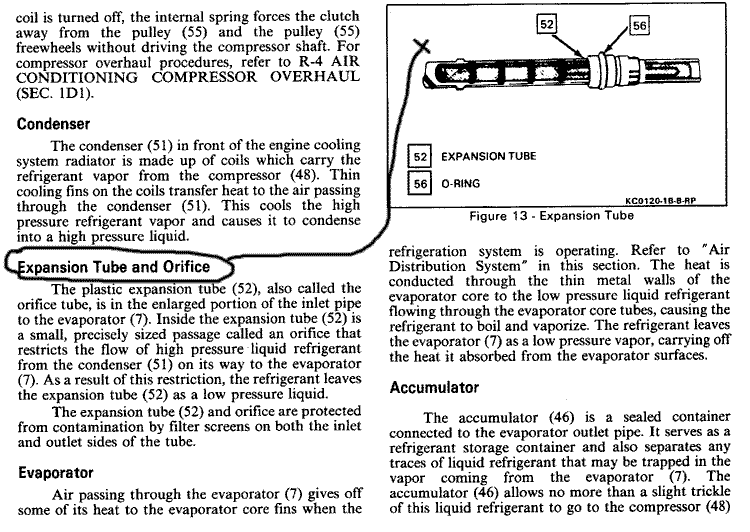

huh? where and what is an old orfice ring??? thanks

Not an orifice ring, just a plain orifice tube or as it is sometimes called, an expansion tube.. It acts as a filter to keep trash and other garbage out of the system. Here is a picture of it.

i assume its the one leg going into the black box/covering?? thanks trick

and you assume correctly. BTW, I haven't forgotten the other info on the cruise control. Just busy.
