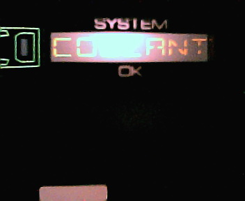

The "coolant" warning on my digital dash stays on all the time. This is on the part of the dash that has the system check. The rad is full, car never over heats(I drive it everyday), the overfill bottle has the correct level, and the car runs great. Any idea why this is staying on? Here is a pic of what I mean. Maybe a bad sensor? It is driving me crazy. Thanks for the help.

Any left field idea's? Everything coolant related is hooked up, maybe a bad ground??? I'm guessing at this point.

pop out the sensor from the coolant tank, and see if you can manually move the float up to the top and make the message go away.
if not then unplug the sensor and see if it goes away.

I think its just a little two wire sensor, cant remember where they are off the top of my head, either in the overflow tank or in the one tank on the radiator. Id just unplug it and see if the light goes out and if it dont take a small jumper wire and touch the two terminals together and then if it goes out you need a sensor or you could just take the two wires and wire them together or just leave it unplugged, which ever way the light goes out, but I know if it were mine Id want it repaired right.

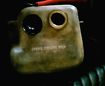

I took a pic of the overflow tank. There is no float in it of any kind. The only thing going to it is the hose from the rad. I also looked on the rad on there is nothing, not even a place where a sensor might go. Should I have one? I don't remeber one on my 92 tbi either, specially on the overflow tank,cause I switch it out for a summit tank. So now back to step one.Dam.

If the digi gauges are stock somebody swaped in a wrong radiator tbi or tpi with analog gauges!
the sensor for the "coolant" lamp is on the passenger side plastic tank of the radiator!
i can post pics on the weekend!
the wiring is shown in the 88 firebird shop manual.....

Ok that makes sense, the rad is out of a 88 formy 350. That being said is there any way to get my "coolant" light to go out, or is it one of those ,just live with it deals?
