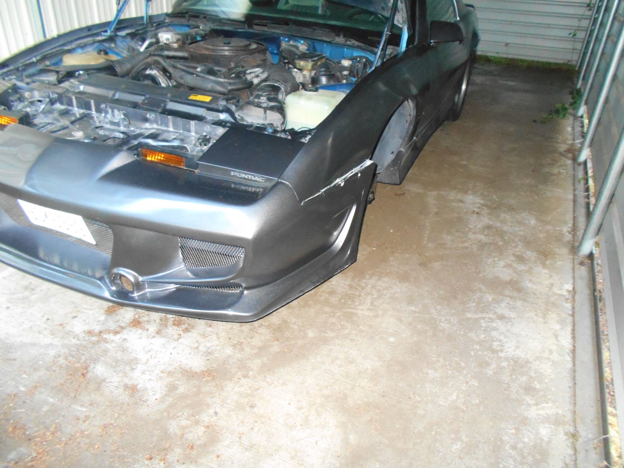

Old Jun 13, 2019 | 01:11 PM
savage56's Avatar
Joined: Jun 2019
Posts: 13
Re: air deflector or air dam
This is what the car looked like after his front tire, came off on the highway doing 60 mph , trying to put back stock .Time for new air dam and front nose piece.
