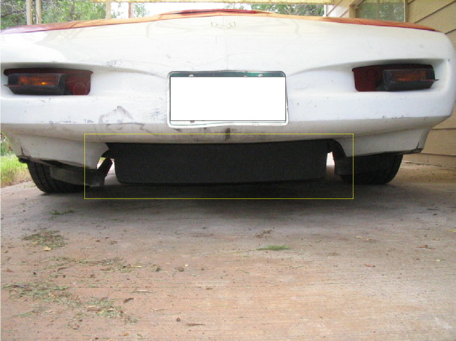

fan 2 should come on with the A/C - sounds like you might be missing the lower airdam. look at the first 4 posts in this forum (sticky's)

This is the lower air dam, right?
If so, Ive got that and there are not any obstructions.
Any other ideas??

No, that's the front ground effects on the nose.
That's an air dam.

hmm... curious, where does it sit? Inside the bumper? Going to have to look, update soon!!

look under the car, should be hanging off the lower radiator support.

hmm...everything looks good.
Well, it all checks out, air dam inplace, and still heating up...perplexed
