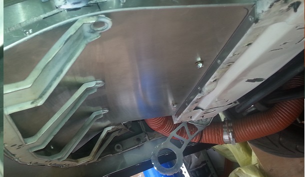

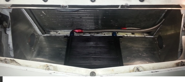

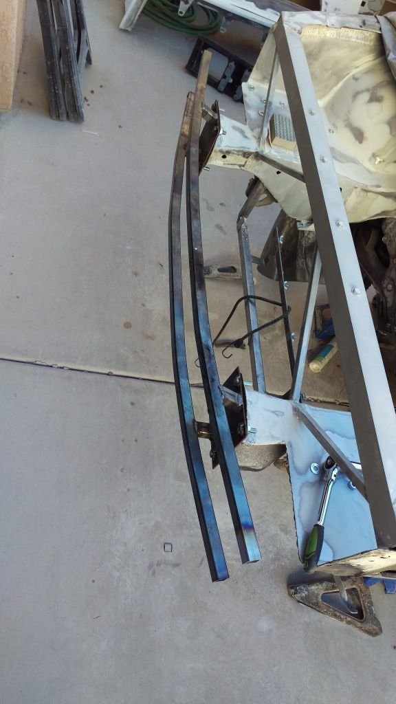

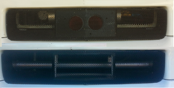

Changed my car from a bottom feeder to front feeder......
Attached Thumbnails making a camaro not a bottom-feeder-before-after.png   making a camaro not a bottom-feeder-ducting-bottom.jpg   making a camaro not a bottom-feeder-front-view-no-grill.jpg   making a camaro not a bottom-feeder-front-view-grill.jpg   making a camaro not a bottom-feeder-top-view-driver-side.jpg
making a camaro not a bottom-feeder-top-view-inside.jpg   making a camaro not a bottom-feeder-top-view-passenger-side.jpg   making a camaro not a bottom-feeder-top-view-top-cover

Hi Tibo, 2 basic reasons....
1). Converted to a LS motor series, ran the car at Fontana and incurred heat build up after the second stint.
The car went into an auto dump mode after hitting hi water temp.
Serious cars are front feeders for air, and I installed an oil cooler inside as well capable of handling BTU's for 450 HP.
2). Now that it's a front feeder, I no longer have to worry about feeder air to lower air dam so I can drop the front lip to the track surface.
I still have two 14 inch high cfm fans with a shroud for the street for cycling when there is no air.
