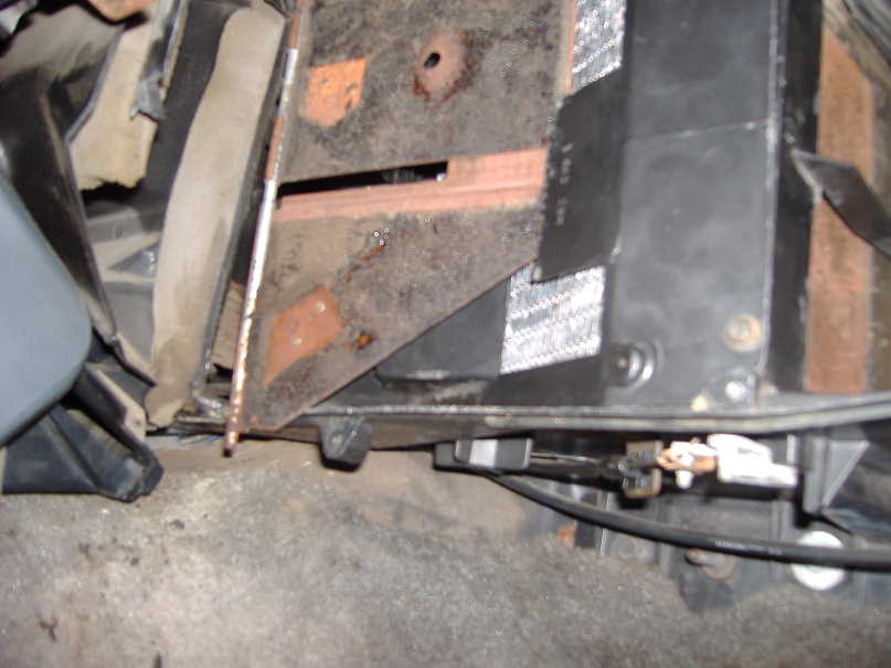

Alright, I found said door, but I don't know how it is supposed to work. The service manual says the door is supposed to change according to vacuum conditions, but this door on my car is pretty much just hanging loosely from it's position. There doesn't appear to be anything connected to it to make it move or change position. Here's a picture to make it a little easier to understand.

I don't have my manual directly at hand. I'd put the system through its paces and see what develops. If necessary, manipulate the door by hand. In one postion or another, it may/should direct the air to the appropriate vents.
JamesC

As far as I can tell, a piece of the area that holds the door in place has been broken off (the bottom part--after tinkering with it I found that the top part of the door has a small hole that it slides into) and it won't sit in place. I may have to scour the junkyards and see how exactly this thing operates. I figure I may have broken it myself in my haste to reinstall my heater core.
Thanks for the help.
