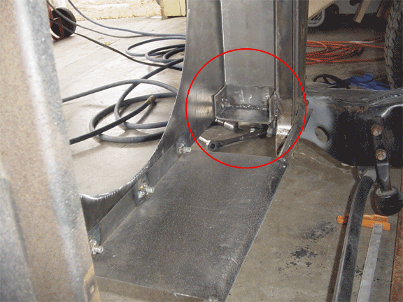

as the topic reads, i need pics of this so i can get an idea of how to make them so im not completely in the dark on this. i'm open to any suggestions, advice or measurements. i have the Jeg's 31x19 Universal radiator for the car. i already have a good idea of how im going to do the top supoprt, its just the lower part is what has me stumped.

This is on my '59 chevy pickup, but it may help. I have the same radiator you have and this is what I came up with. It is just a U channel on the bottom for the radiator to sit on. It is welded to my radiator brace I just made a custom shroud that hides it. I will lay in some foam for it to rest on.

alrighty, thanks, that does help my out alot. that looks pretty good too.
