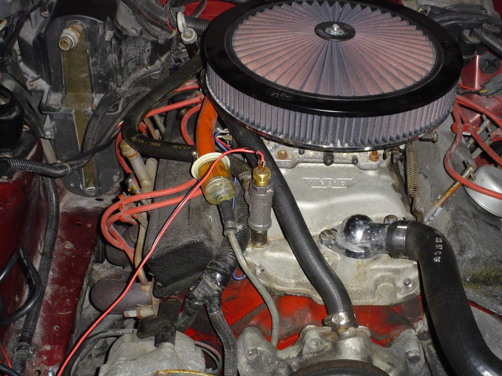

Well, back to the drawing board. I used a plumbing tee and hooked the switch into the fitting where the coolant leaves the engine and goes to the heater hose. It just doesn't quite get hot enough there. Now, I can either buy a lower temperature switch, or try a different location.

Update: IT WORKS!
It looks rediculous, but it works, somewhat. I noticed that for the first cycle, the switch does not heat up as fast as the engine. So, for the first 10 minutes or so of driving, I have to switch the fan on manually once or twice. Then, once it heats up, it holds the temperature at exactly 220 for the rest of the drive.
One snafu- make sure that the switch gets its positive power source from a switched circuit. I originally had it hooked directly to the battery, but this allows the fan to run when the engine is off. And, since the coolant isnt flowing, the fan will take a while to cool the switch off.
Is it perfect? No way. But, it will hold me over at least until I install the aftermarket fuel injection, which controls a fan anyway, I believe. I'm still looking into an adjustable electronic fan switch that uses the factory temp gauge as an input, but who knows. Here is a pic of my ghetto-ization:
