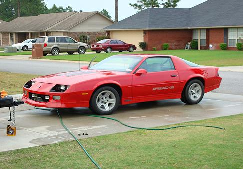

I am including a pic of my steal. Any tips/advice will be appreciated.
