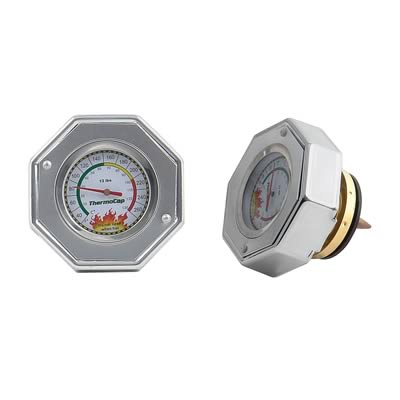

If you really think its your gauge and the engine is not getting hot, try one of these radiator caps. Its called a thermocap and ive seen them at advance auto. Cheaper than an autometer gauge, plus u can make sure your car isn't overheating while your working under the hood with the car running.
