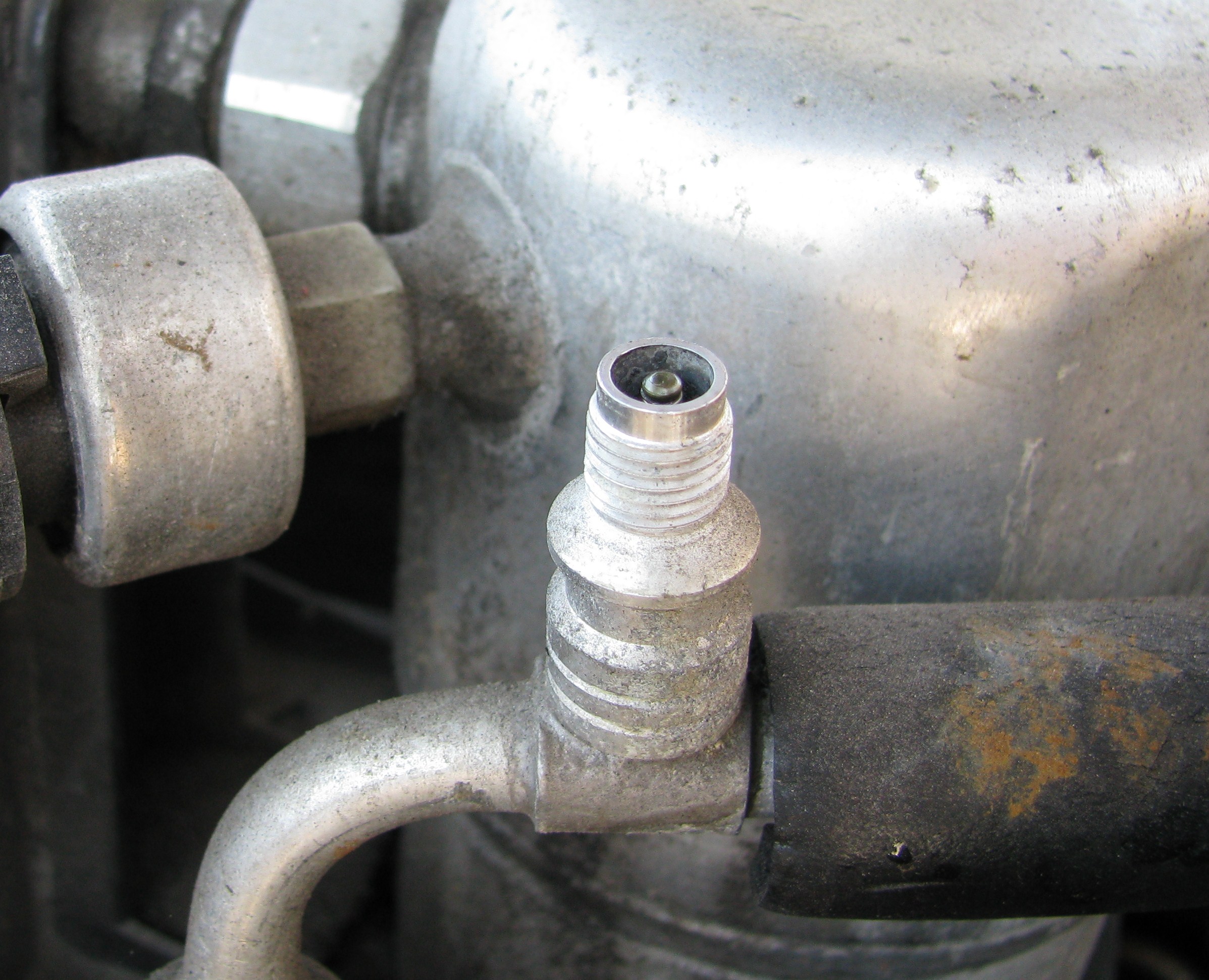

so can someone help me ID if i have R-134A
so im looking into refilling my ac system. Take a look at the pic can someone tell me if those service ports car R-12 or R134A thanks
Attached Thumbnails so can someone help me ID if i have R-134A-ac-system-080.jpg   so can someone help me ID if i have R-134A-ac-system-081.jpg

those are r12 ports. r12 has threaded ports, r134a has coupler type ports.
