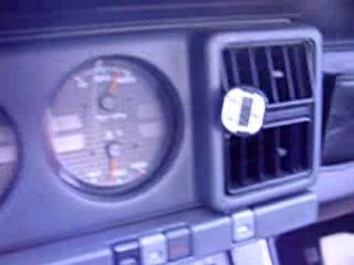

I filmed these a few years back. You just can't do this on R-134a.
(driving down the road)
(drain after parking the car) The line of water that follows me to my parking spot is hilariously visible.
15 minutes later....

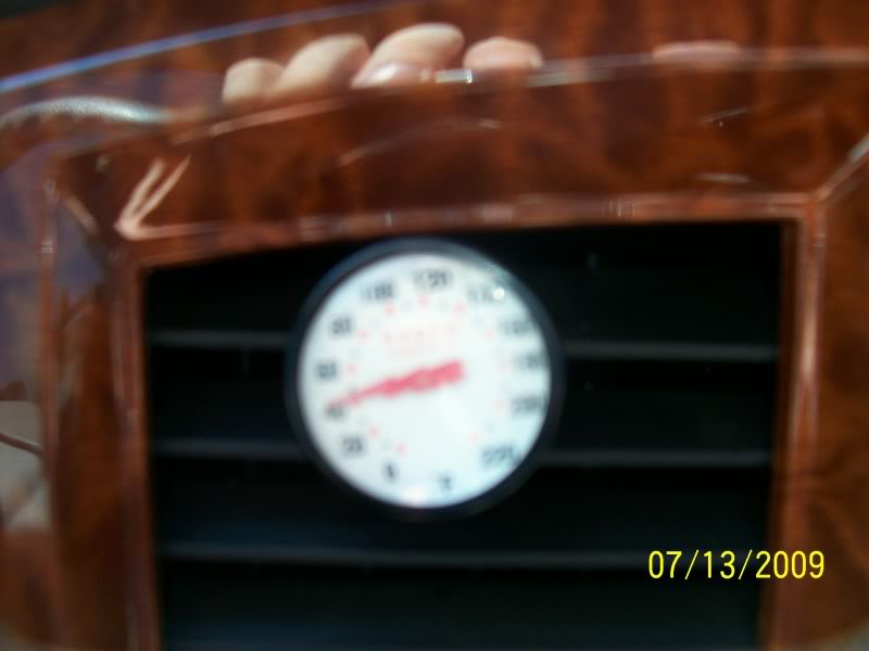

I must admit I don't mind the R-134 interior temps....regularly high 30's vent temps in my DD 05 Yukon Denali on a 95F day but man, that'd be killer to see vent temps as low as single digits! I wouldn't want to ever get out of my car! Hell, I'd be mad my car gets colder than my home AC unit! Lol....I may have to try the 406A just for the hell of it....
