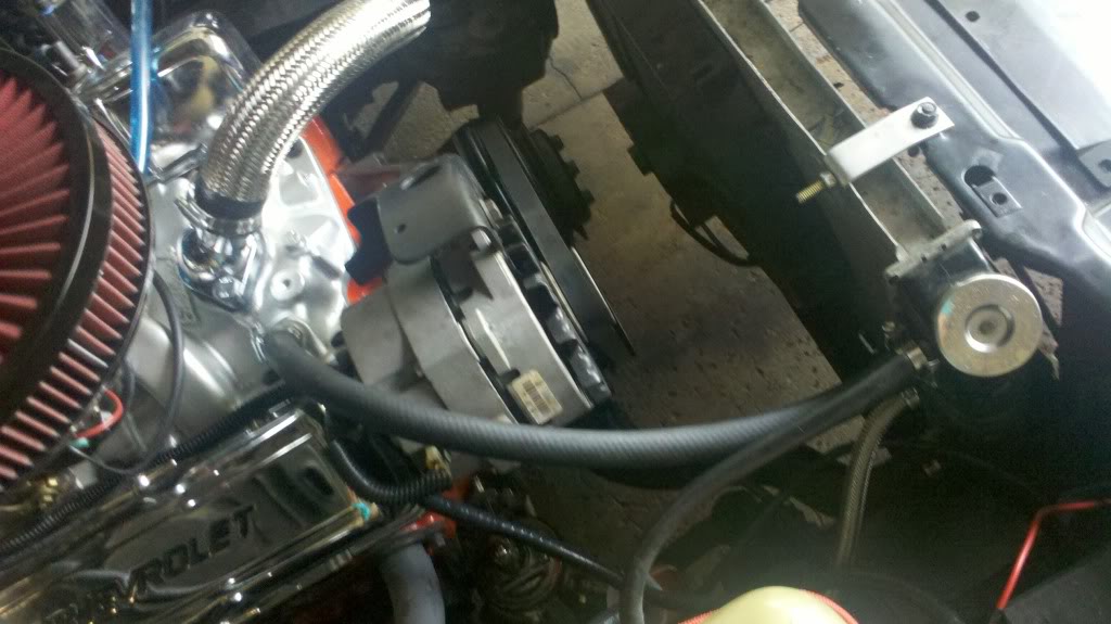

This is a picture of what i am trying to explain. The black hose going from top pass side of radiator to the intake.

Oh that shouldn't be like that. What you want is that one off the radiator to go to heater core if you have it still. You can usually attach the other hose from the heater core to the aux fitting on the water pump it's on the top side if you have it. Or you could hook the intake one up to a hose into the heater core and the radiator one to the other heater core side. Idea is to just get some hot antifreeze to go through the core to warm it up. If you're not running a heater you should be able to cap that off or plug it on the radiator. That's just my sugguestion I'm sure someone else will chime in.
All you're doing there is bypassing the radiator some. The coolant isn't flowing across the fins it's just piping it right back into the intake for more circulation.

with that hose from the intake to the radiator tank,
coolant will flow from the intake to the radiator tank to
be picked up by the water pump to be circulated back
to the engine-bypassing the radiator and not getting
cooled...
you can remove the hose,plug off where it was
connected,and drill a hole of around 1/4"in the
thermostat flange for "bypass"circulation.

Just plug that line make sure fans are working u might have an air bubble or 2 in there u dont mention the thermastat might want to check that getting timing dialed in and useing the manifold vacuum port helps with overheating also if everything else checks out

What would you recommend i use to plug the aux hole in the radiator with?

You might be able to find hose caps. There basically rubber hoses with a capped end and put a hose clamp around it. A small piece of hose and a bolt shoved in the open end might also work if you can get it clamped tight enough.

Ok i will take a trip to autozone after work today and see if i can get a hose cap. Do you know what size that would be? No i will not be using the heater. The Heater and AC have been deleted.

Need it the same size as the hose you're using on the connection right now if it fits properly.

Piece of hose lug nut hose clamps silicone done
