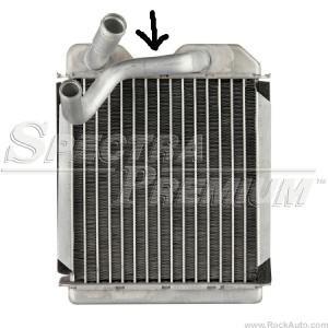

I Replaced Mine A Few Months Ago I Used The Spectra Premium 94606 It Has The Notch In The Core Like The Factory Did ,The Heater Core Clamp Goes In This Notch And Screws To The Heater Core Shrould To Hold The Core In Place The Cores You Mentioned Don't Have It
