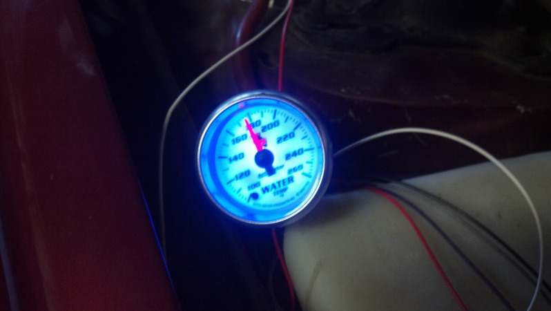

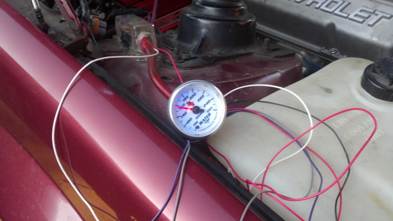

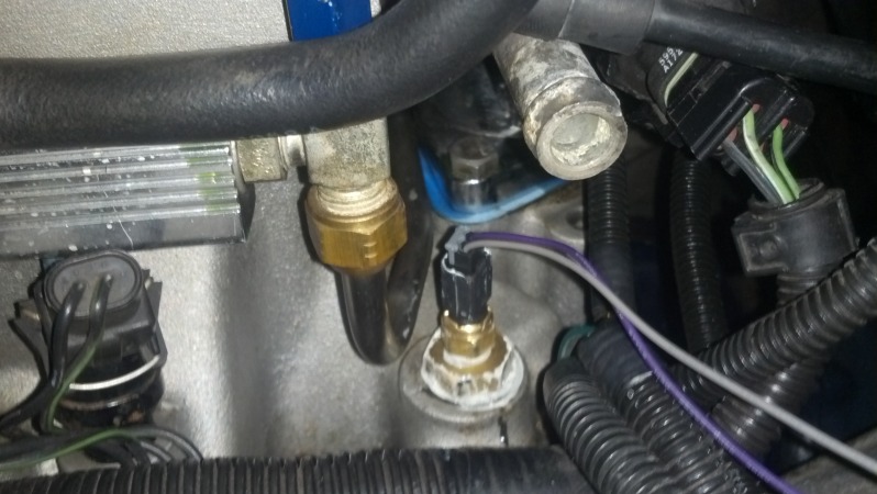

Decided to take vetteoz and maddens advice from another thread.
I wired the coolant gauge into my manifold. Unfortunately the manifold is tapped for 1/2" and my sending unit is 1/8" so I had to use a reducer. Thats the only way to get it to mount in that position. The reducer pretty much covers the entire prong of the sending unit, so some coolant is touching but not a direct flow. Does that matter at all? Questionable.
For the time being I left my fan switch in the stock head position just to see how the gauge would read. 176* on I believe is the setting on it.
After idling for 5 minutes, one of the fans kicked on. According to my gauge this was around 140* which would mean premature, but if the coolant in the head was hotter than the manifold (or the probe is not getting a correct reading), then this is why its happening.
After 15 minutes of idling the gauge slowly creeped to 180-185ish and hung around there with only the one fan spinning. I could put my new fan switch into the manifold with a 1/2 to 3/8 reducer as well, but that just means it would take even longer for the fans to come on...
Now is it really at 180? that is the question.
IDK, anyone have any advice? 30* is a lot to be off by..
