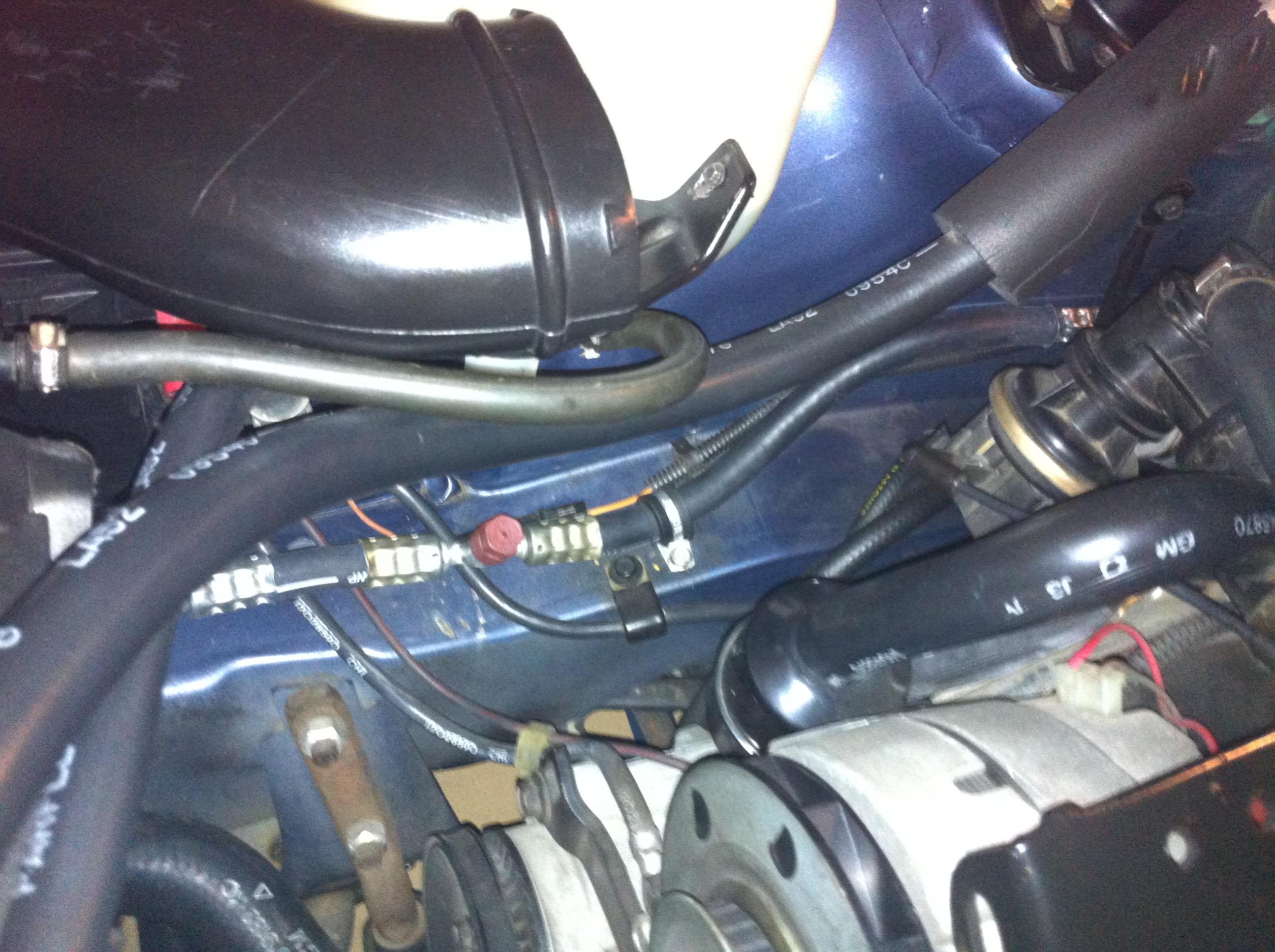

Here's some pics of mine with the new high pressure hose. It was actually fabricated at the shop that did the a/c conversion work. Costs for parts about 46 bucks. Works well so far.

Here's the OEM high pressure tube: (For comparison)
