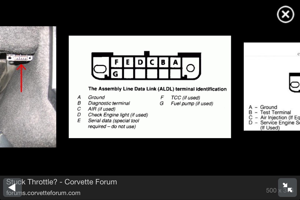

You can only check the timing with a light. Plugging a scanner into the ALDL will not only disable some ECM commanded timing functions, but the ECM doesn't KNOW what the base timing is anyway. It only adds timing to whatever it's set at.
If timing is within 0-6 degrees base and you have pinging at low speed cruise with throttle tip in, I'd do what someone above recommended and check EGR function. You've got an 82? Shouldn't have a KS and should have the lower compression motor.

As stated above you can't check base timing thru the ALDL. The computer doesn't 'know' what base timing is, it only adds to it. You have to disconnect the four wire connector to the dist and put a timing light on it.
Airflow or coolant flow.

I thought you can pin a and b to check base timing? I've tried both ways and still have it set at 6 btc. I can't figure this out.. It's nuts and makes no sense. What do you think if some of the coolant passages were plugged?
