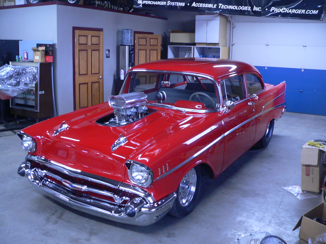

[ATTACH][/ATTACH]I also used this fan on all these applications, all supercharged, and many more. Worked very well. (Black blown 502 57 street, purple blown 632 Merlin street, 572 blown Datsun ( that is not me, just my shop. I am uglier than that, LOL )
Attached Thumbnails Reasonable "Painless Wiring kit" for Electric Fan-custom-bad-rat-aerial   Reasonable "Painless Wiring kit" for Electric Fan-p1050135.jpg   Reasonable "Painless Wiring kit" for Electric Fan-p1010852-640x480-.jpg

WOW, Really nice cars. You’re not going to be hearing any fan over those.
As far as fan sound goes it’s really too bad about mine because it’s only a14in puller mounted over a large combo cooler then to the new OEM radiator. It and the 16in pusher in front are each independently wired with adjustable controllers.The puller that makes the noise is primary and on at 190 with a 180* stat. The pusher is on at 200* and between the two it stays there or below. That little fan has got to go though because I can hear it above the engine and a Flowmaster 80 series cat back. I love to listen to the car and as I said it’s got to go. I would hate to see someone go through all the trouble of wiring in a fan just to find they can hear it over the car. I think I will secure the new fan to a nice level piece of driveway and run the wires directly to the battery to make sure it’s quiet enough before I go through the trouble of mounting it. I recommend that to anybody thinking of putting in a fan.
