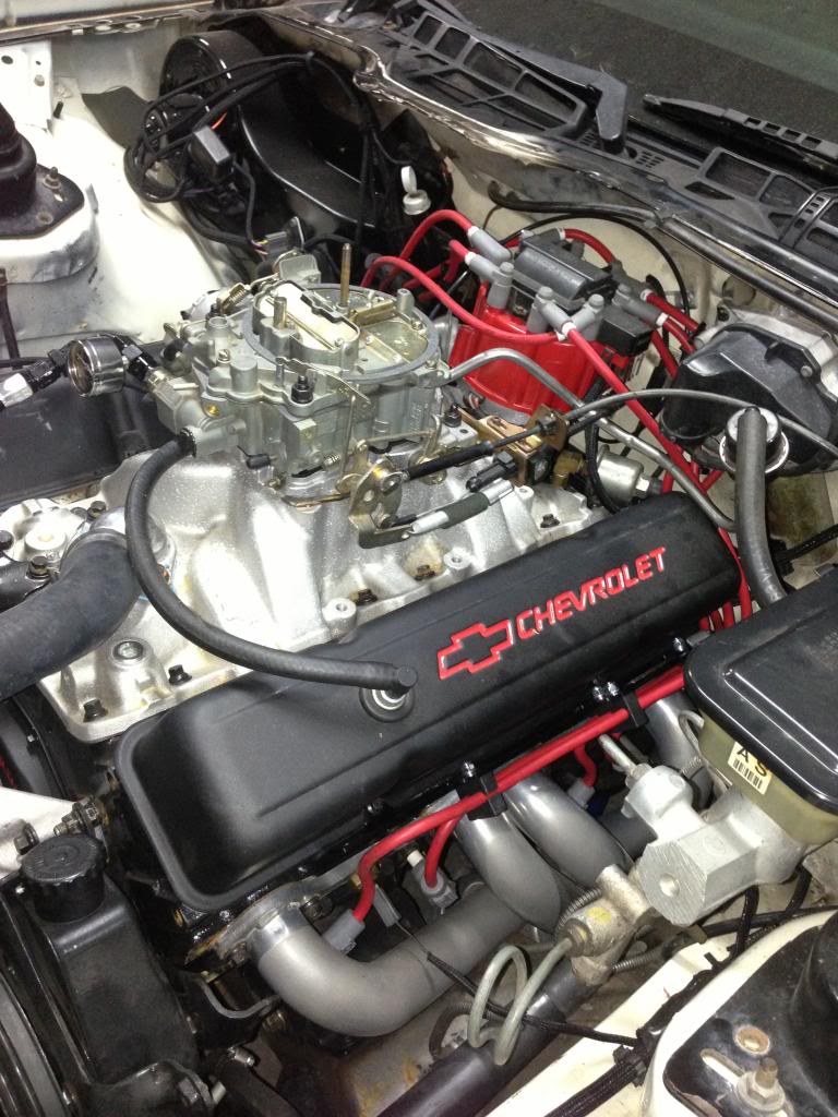

I deleted the AC in my 84Z some time ago and noticed just tonight that I think I may have too many wires still under the hood near the air box.
I saw multiple pictures of people on having 2 sets of wires/connections going into the box. The 3 or 4 prong one (the bigger one) and a smaller one, which I assume is the power for the fan.
Here's a picture of what I currently have. Notice that I have a gaint relay/connector in the middle that looks like a rat's nest. I know the orange arrow is good, but I'm thinking I shouldn't have the green arrow. In the picture I'm using I still have the CCC wiring still hooked up so please disregard
This is the best picture I have of the engine as it stands. Again, I think the larger relay needs to go
So I guess my question is: Do I need this larger relay or can that be removed as well?

You need that relay for your blower motor. It works in conjunction with the resistor to give the motor the varying voltage to change speeds.
