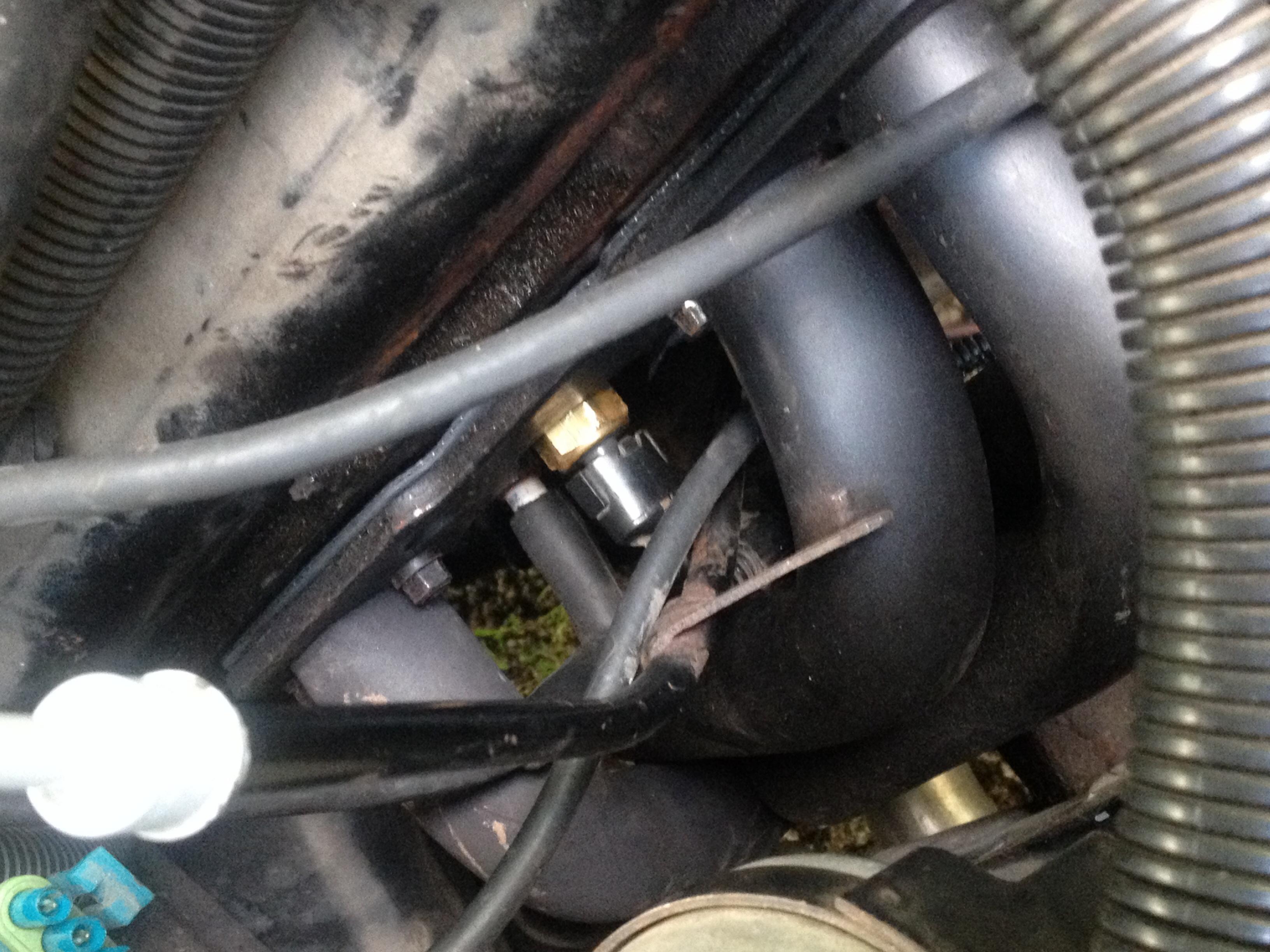

Is this the engine coolant sensor?
Does this tell me the temperature of my car?? 1986 305 carb

No. Your photo shows the coolant temperature sender for the cooling fan.
The coolant temperature sender for the gauge is in the left (drivers side) head between cylinders #1 and #3.

Well I found it and is there a fuse for it?
Old Sep 2, 2014 | 06:58 PM
Posts: 28,031
Likes: 2,500
Re: Is this the engine coolant sensor?
No
Same fuse as all the rest of the gauges

So Is the wiring bad or the sensor?
Old Sep 2, 2014 | 08:33 PM
Joe Tag's Avatar
Joined: Jul 2011
Posts: 1,613
Do you think we have enough info to decide that? Going to have to do some investigating. Easiest way to start is grounding the green wire and looking for the gauge to peg with ignition on.
