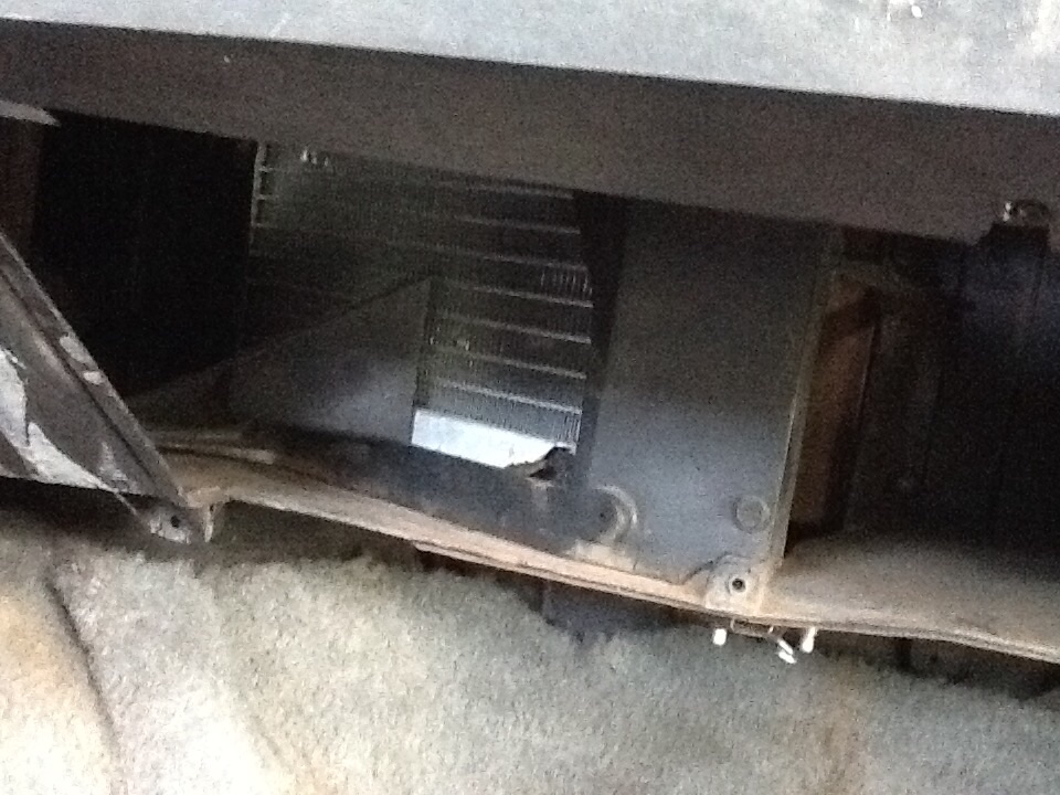

Why did I pay this clown?
I posted earlier that I had to do a heater core change after paying some clown $540 fifteen months ago to do it. My windshield is already fogging up on an 84* day with the heat off. He said it "was hard", but he got it done--took about 8 hours he said. I decided to do it myself this time, and lo and behold, I don't get what the big deal is. I've been working on this less than an hour, and could have had the hvac cover off in 15-20 minutes had I not spent time poking around and known exactly what to do. It's off as we speak, pics below to prove it. All you have to do is take the map pocket off, unscrew and unplug the DERM module, drop the ecm and bracket, then drill a hole right HERE. pic below... The top screw is right behind there, I used a long extension and it came right out. Now I'm not saying it won't be work to get it back in, but good grief, tape the crew to the socket--whatever. I'm more amazed than ever that I paid this clown $540 for what will be a couple hours work TOPS. CLOWN! I wanted to pull the map pocket anyway to clean and re-glue it. I have to be honest and say, I was gonna drill a hole right here, but when I pulled the map pocket off--there was already a hole there! I don't think it's factory because it's not exactly round. There SHOULD be one there, but I think someone drilled this one. I'm not sure. Either a PO did it, or Mr. Clown did it and took a 6 hour break afterwards on my dime.

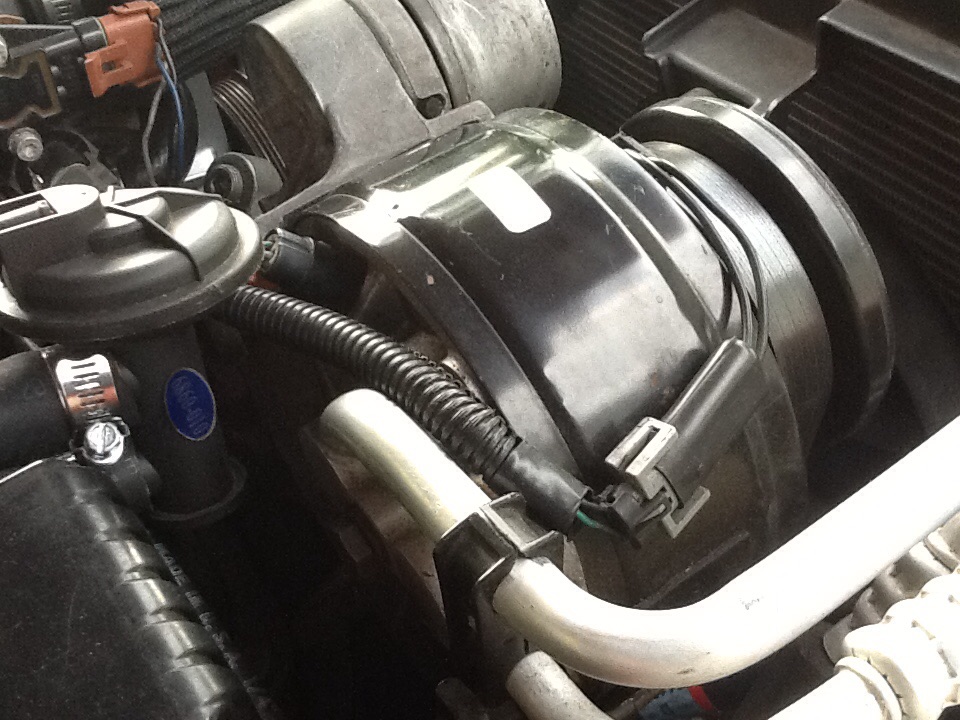

Here's another small clue. I just went out and gave it the once over again. Tried the pressure release deal on the AC, and it was almost completely empty. It barely hissed a little for 2-3 seconds, and then nothing, just like a flat tire. Now that probably explains why the AC doesn't work, it needs to be charged. But, if it's empty, does that rule it out as causing the windshield fogging? Just to be clear, I opened the valve that faces in toward the motor. There was another facing upwards, did not open that one. On the pic below, I opened the right hand valve.

Re: Why did I pay this clown?
Originally Posted by mk1431
does it still fog up? maybe the a/c had 1 last poof now its empty wont happen again ? the evaporator is in the car condensor is where the radiator is
No way to tell just yet. I hadn't drove it since Thursday, and just now depressureized the AC. I'll drive it this week and see if it fogs up again. But so I understand, if it does fog up again, does that officially eliminate AC as the cause?

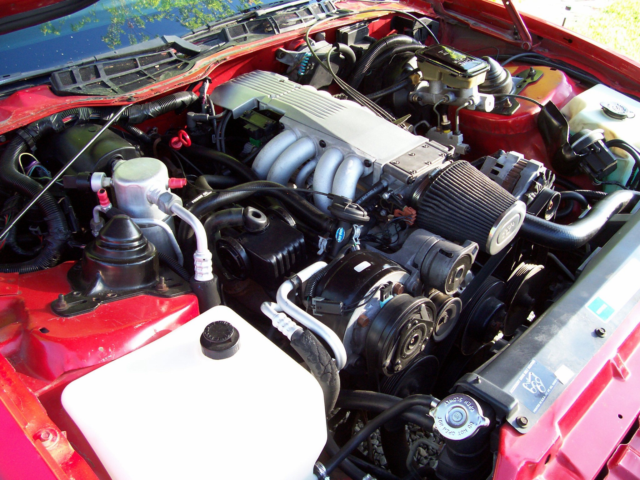

in your pic is that a aftermarket a/c compressor and did you retro fit to 134? just curious cause mine doesn't work and leary on the conversion kits
Old May 31, 2015 | 10:59 PM
TheExaminer's Avatar
Joined: Dec 2013
Posts: 1,122
From: Indiana
Car: 92 Formula WS6, T-top
Engine: 5.7L T.P.I.
Axle/Gears: Limited slip, 3.23 10 bolt
No, I didn't do it, but I'm glad you brought it up because I had a question about that too. I'm sure you're right, but I don't know as much about the AC system. What is it that tells you it's an aftermarket 134? You're the second poster to mention that to me. If so, that'll make it easier to charge--134 is what's mostly out there now isn't it? It was an Arizona car when I bought it, so Im sure AC was a big deal. If this is true, I feel a lot better about just charging it and seeing if it works. I'm probably going to pull the compressor and bracket to clean it and maybe paint the bracket if practicable though while the system is empty--along with whatever is on the engine block behind the bracket. Did the same thing to my power steering pump bracket when I changed that out.

it dosen't look like mine no harrison label and my wire run over the top of compressor like 1 oclock pos. yours looks like an extesion wire was put on and run at 9 oclock position . 1 easy way too tell r12 has threads on the outside of the schrade valve 134 has a quick disconnect cant see cause of the red caps you have on them. the compressor can run both .

I had to unscrew that cap, someone just put a piece of red electrical shrink wrap type stuff on them for some reason. Don't know if that's factory or PO, but there are black screw caps under them. At least, there are threads on the right hand one. The one that points upward I couldn't get off. It turned, but never unscrewed and it didn't want to force it. It may have some different kind of disconnect, idk.

can you get a closeup pix for me. if i had to guess from the pix posted i would say it looks like 134 disconect the shink wrap is def. NOT factory my guess PO wasc chasing a leak and shrink wrap to seal the caps ???? maybe leak was evaporator?? if there caps under the wrap cut the wrap off cause you got no freon anyways drive first before you recharge ac

Ok, I'll get some pics tommorow when I get home from work. I cleaned the windshield pretty good today, I'll drive it to work tomorrow or Wed to see if there's any more fogging.

Here you go mk.
