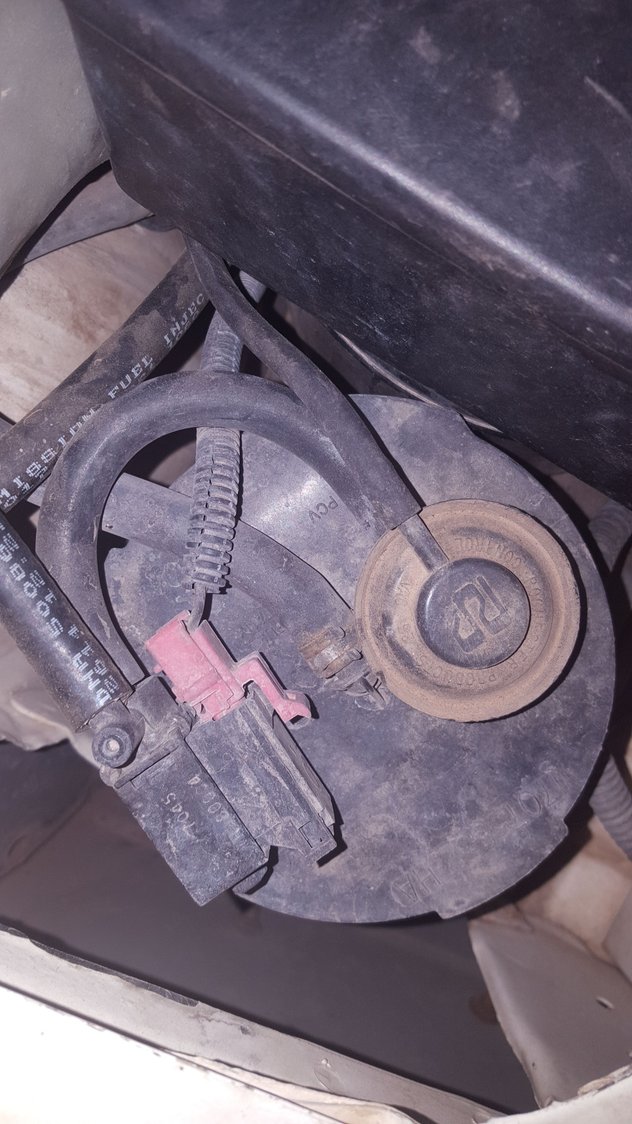

Unfortunately I haven't had a break to do any work. I did notice tonight this vacuum line was unhooked. Also when the car gets over half the overfill goes all the way to the top and stops?
Unhooked line
The round portion on top is where it connected to
