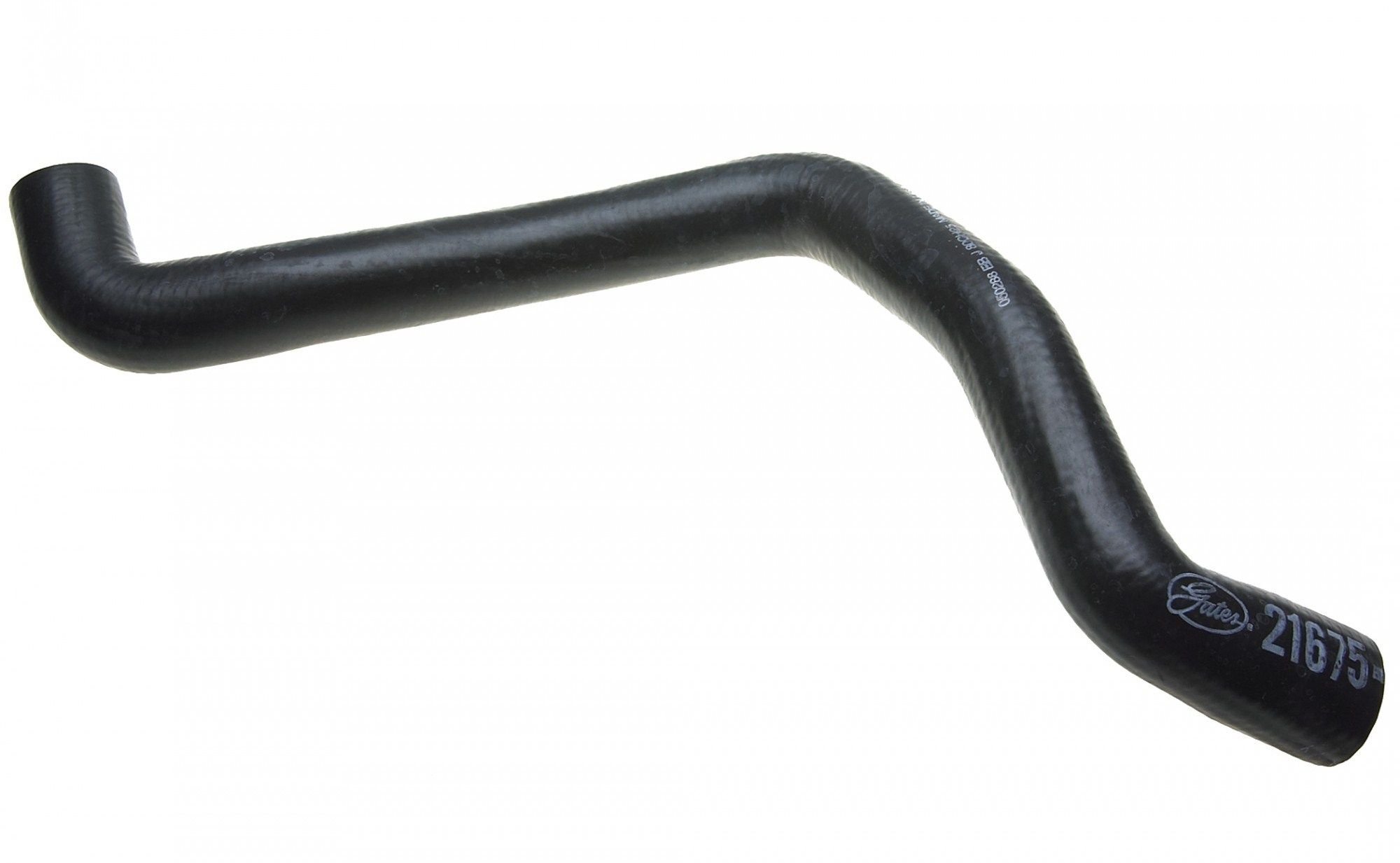

Does This Gates Routing Look Any Better.

Yep, the one that gt4373 pictured is the correct one. Should fit perfect

Yeah guys, the Gates hose is the correct routing. I feel the need to find out whoever makes Dayco hoses and tell them the one for our cars is incorrect. Thanks for the suggestions!
