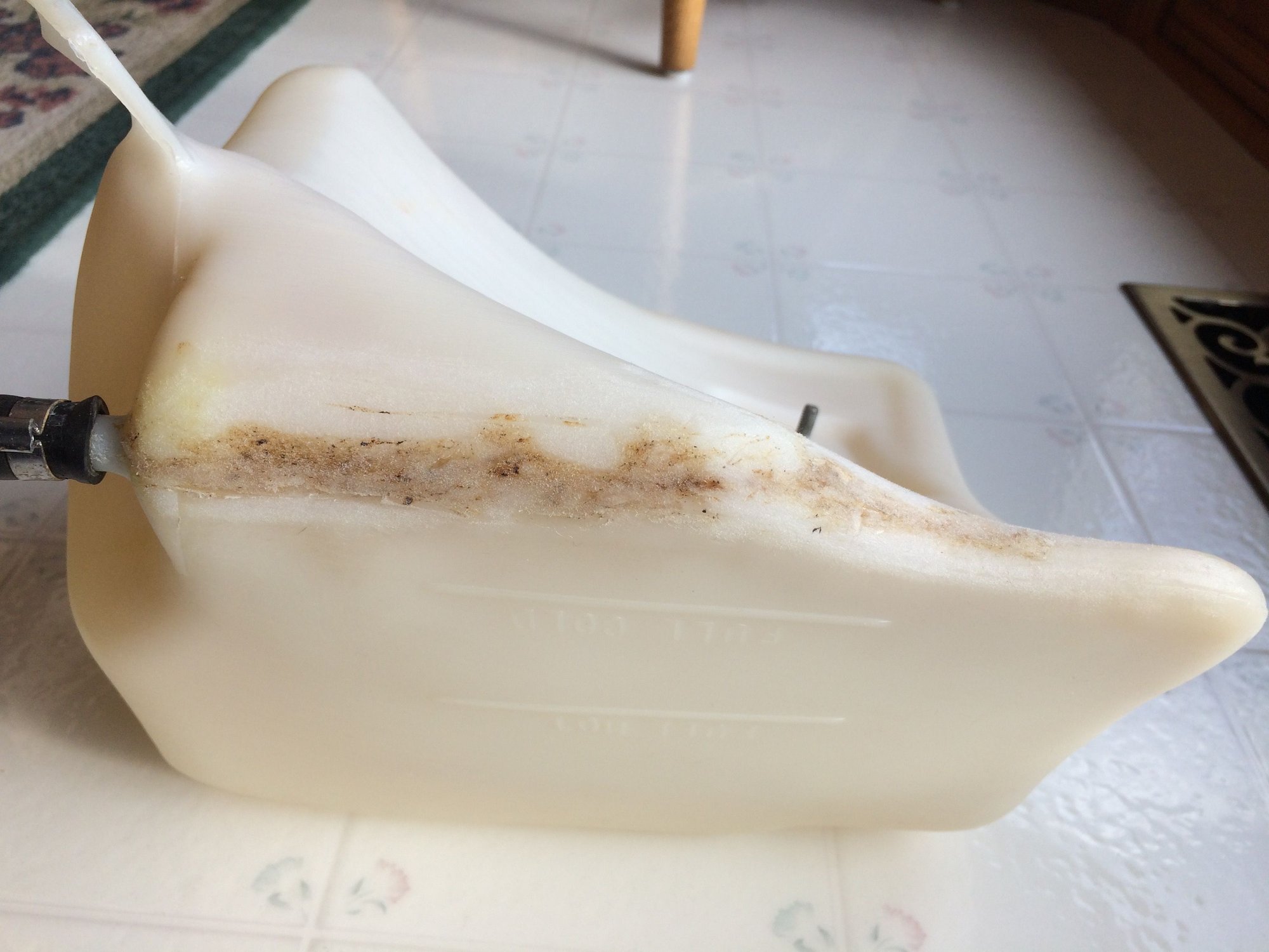

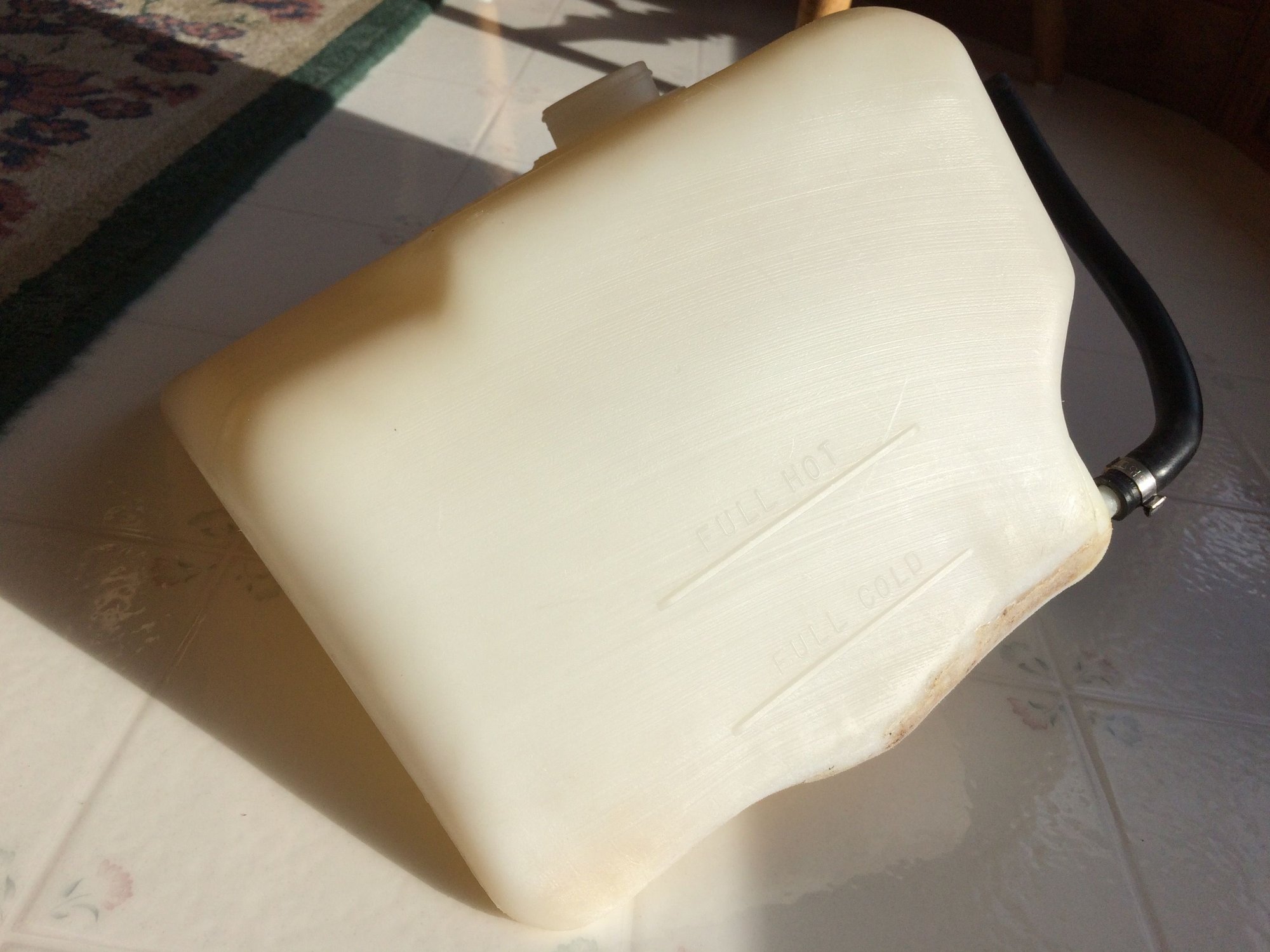

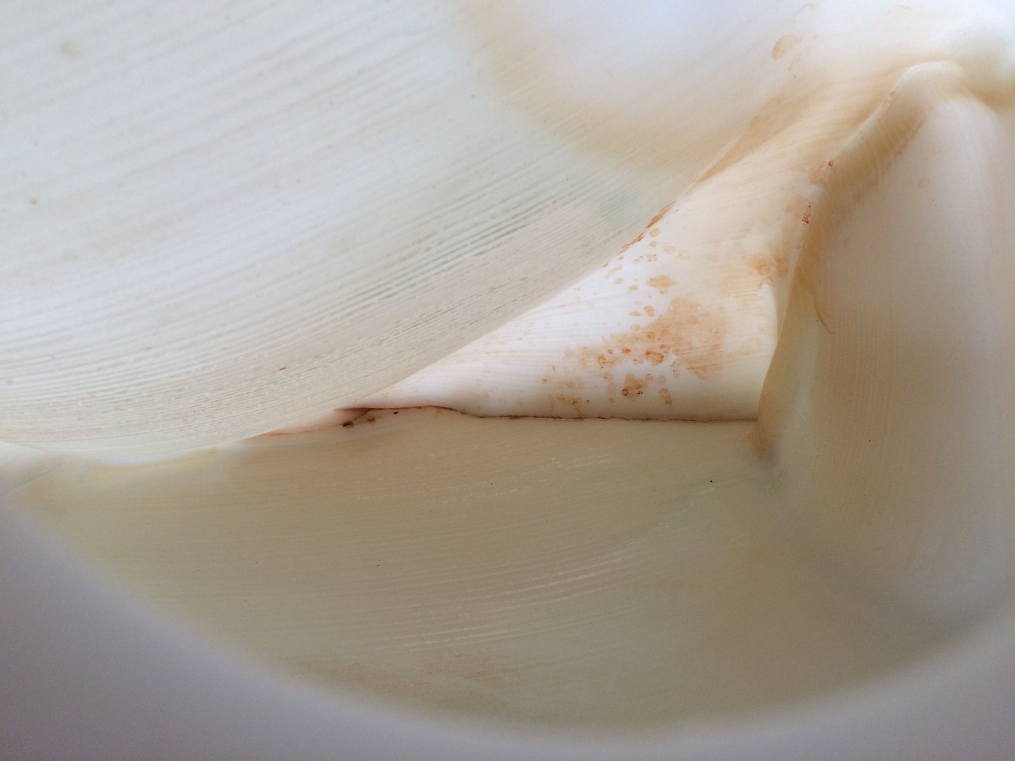

I decided to keep the OEM if possible. Bleached the tank with Clorox, Oxyclean, a little Dawn and a bunch of BBs. Changed the solution twice over a soaking period of about 4 days. Don't have a beginning photo but did get most of the yellow out. Welding the plastic seemed to work well with the exception of the crud in the crack staining the melting plastic. I tested the tank with boiling water and it proved water tight. One photo shows the weld and the second shows an interior view of the crack. Interior view
plastic weld result showing staining from the crack contamination
overall view
