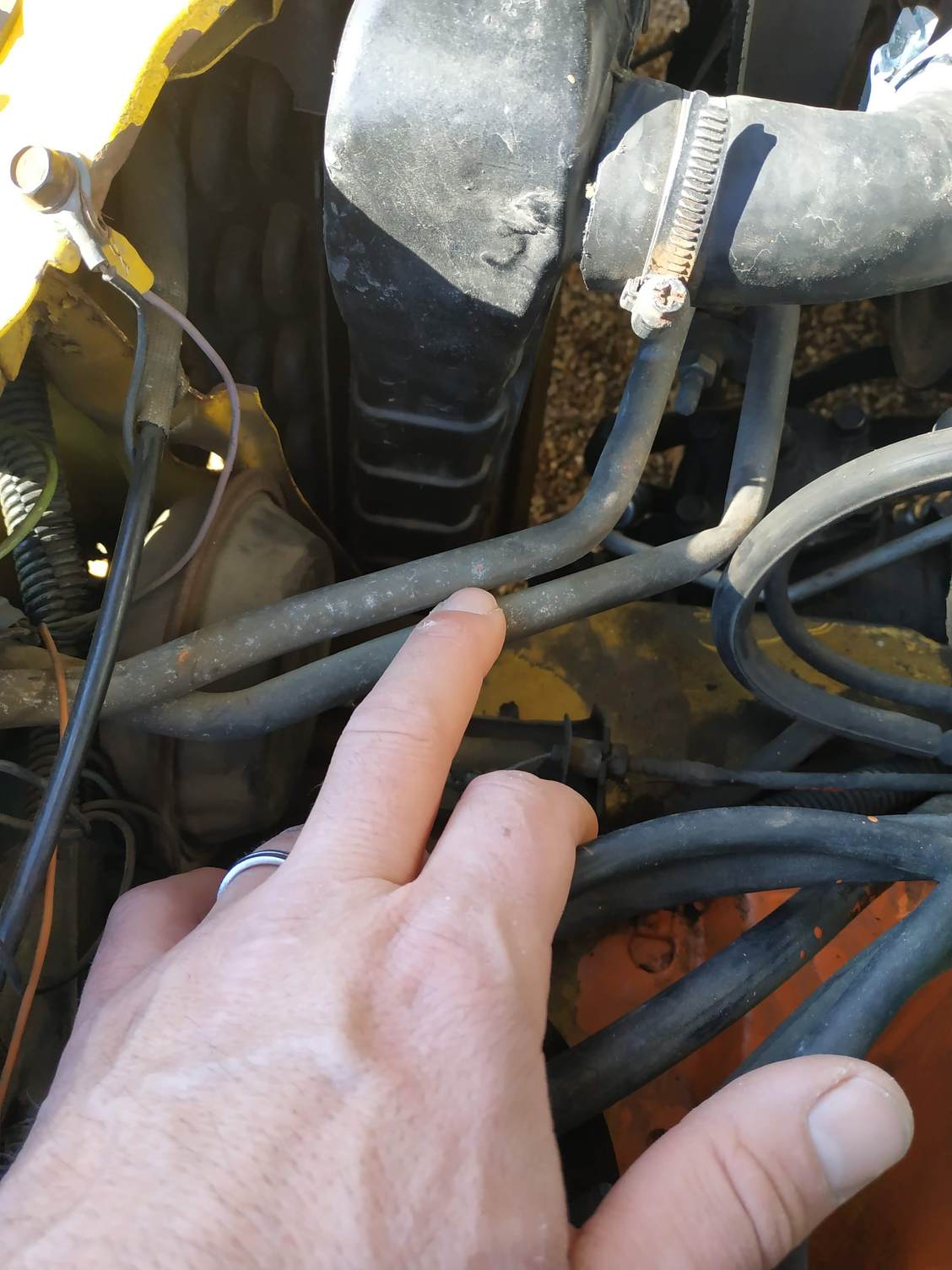

My Z28 1984 pass the winter in my garage. Now the nicer days are comming but i'm overheating in town or roads.
Means before i was near 105°C (middle of gauge) , then now i'm going udner the red zone, so i put heater in car at highest level to have it go down and being able to go back house. I
  • flushed the radiator : The liquid was clean green/yellow, no oil inside, not dirty.
  • I cleaned inside with the product adapted, run in temerature, then fulshed a second time , then new coolant liquid.
=> Same trouble, need to put heater in car to have the t° lowering down.
1°) My car was equiped with AC , but there in no compressor for years, and i don't plan to reinstall. Can i remove the little radiator in front of the big one to have more airflow ? (see picture of radiator and my fingers , can i remove screws here ? (no compressed fluid inside? no troule after ?)
2°) the plastic part is present under car like i read in some threads
3°) is the only option have to add two blowers in front of radiator ?
Best Regards
Laurent
fan behind radiator
can i cut here those two parts that goes to little radiator
plastic part for air flow
the little radiator in front of big one
big one is not new of course

Borrow an infrared heat gun and check that the engine is actually overheating; your temp gauge may be inaccurate. Past that, if the car was OK when you parked it, the thermostat maybe stuck shut. Remove it, tie a wire around it, and dunk it into a pot of simmering water to see if it opens.
Yes, you can remove all the AC components---if the system has already been professionally evacuated of refrigerant. You'd do well to remove all parts, lines, etc., intact and save everything in case you decide to replace it at a later date.

- the "little radiator" looks like a factory installed oil cooler-is your car a z28-E ?
- the lower fan shroud is missing-this would be installed on all A/C equipped cars-certain non-A/C cars did not have full fan shroud
- A/C condenser is still in place and you will improve high speed airflow a little by removing that
-stuck thermostat is most likely the cause of the overheating

If the car ran at the correct temp before the winter, hacking parts off of it now isn't going to REPAIR it. Might "fix" it, by some sort of accident, but … the operative concept remains, "hack".
Check the actual coolant temp with an infrared thermometer. You can pick up a sooooper cheeeeeeeeep but entirely adequate one at Harbor Freight. Probably plenty of other places as well. The temp might be fine, and all you need is a sending unit for the gauge.
Come back and let us know, and we'll guide you in the right direction that DOESN'T involve hacking on your car.
I would NOT recommend, under ANY circumstances and/or for ANY reason, hacking the AC off of the car. There are few better faster ways that I know of to turn a really nice cruiser into a filthy interior, BO bomb, trailer-trash POS than that.

Thanks for your mails.
I'm now not as hot as before my coolant liquid change. It's better. I'm just over the middle, it was little under middle before.
- I will try to find the bottom lower fan shroud on rockauto that will help
- what about the fans that push air in front of radiator ? any kit easy to install that doens't hack the car ?

Find what broke and repair it. Something has changed: your best plan of attack now is to UN-change it. Put it back the way it was.
Don't pile more stuff onto the car that it didn't need before, while leaving something else broken. That's not smart.
Yes you should replace the lower fan shroud. Especially, if that was there before, but this started after it went away, that could very easily be the actual problem.
A trip to the high-pressure spray car wash might help. Everything works better when it's clean.

Check for mouse nest stuff between the radiator and whatever that thing is in front of your radiator. Had the same issue for ages on my '88, and found it stuffed with leaves, rags, and cigarette butts where a mouse had built a nest there. It wasn't even visible until I pulled the radiator away.
