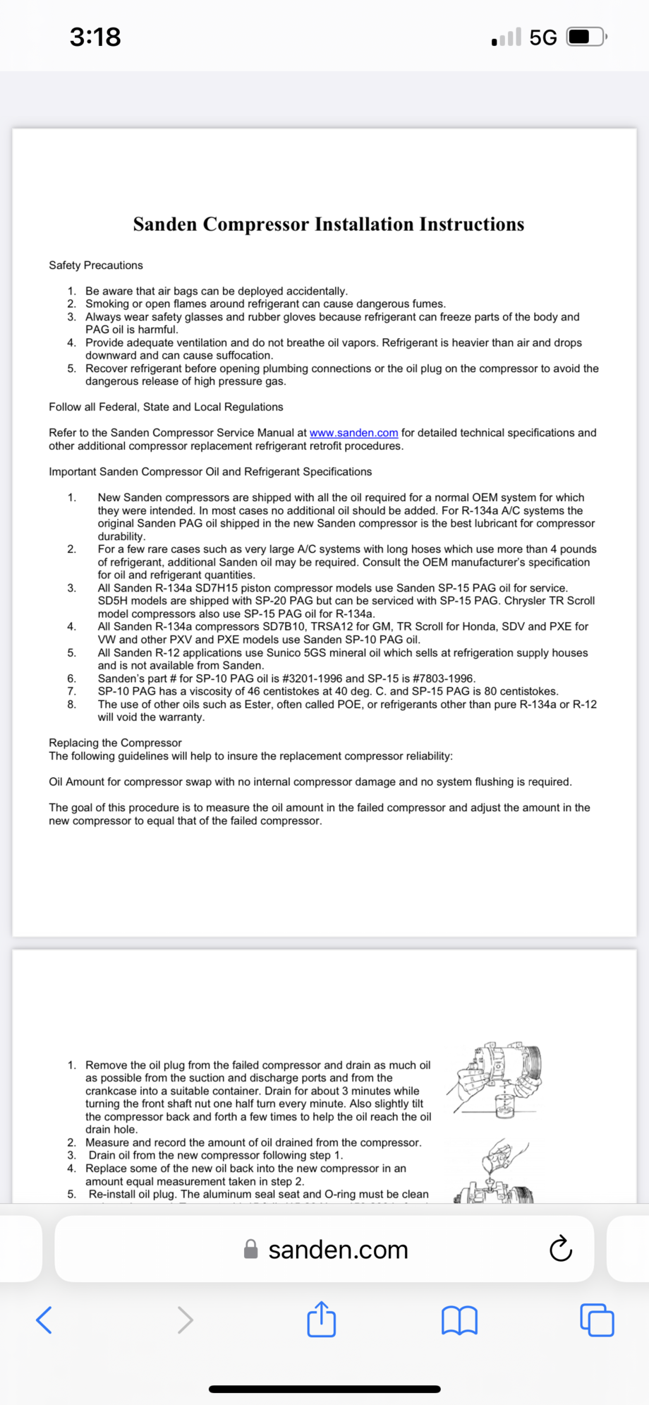

I called Holley and the tech rep told me it comes filled. He sent me the manual.
manual says “Sanden service compressors are supplied with a full oil charge as indicated on the label above. This amount is consistent with the original OEM charge used during vehicle build” but it also says fill with the right amount of oil for new systems.

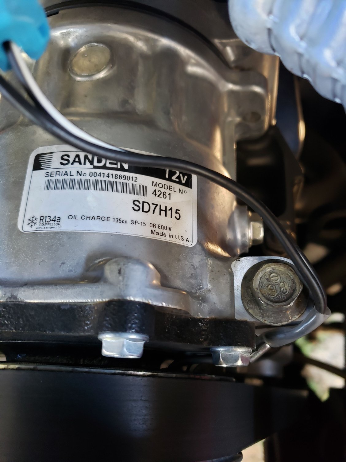

Not sure which Sanden that system comes with but I had to add a lot of SP-15 to mine, to total 11oz because of the dual evaporator system. My SD7H15 had 135cc oil precharged into it.

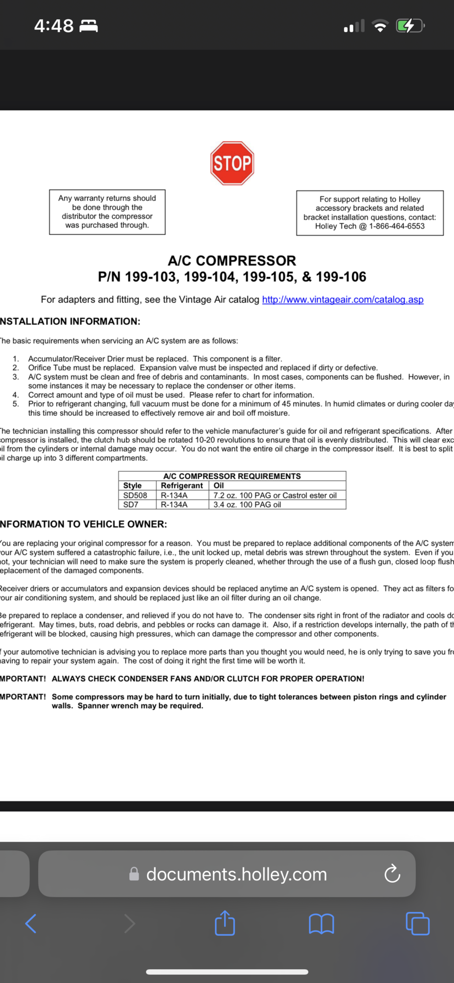

A little update:
the Holley part number for the compressor is 199-104 (black). The part numbers range from 199-103 to 199-106 Depending upon your color.
I looked the part number up and found the actual manual (see photo). It’s my understanding that I have to use 3.4 oz of the PAG -100 oil.
