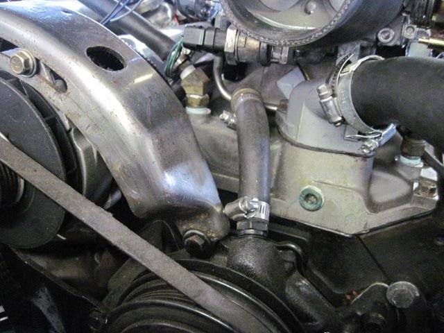

I've got the same block, with a vortec based HSR intake, here's a pic of that bypass hose connected so I'd say yes.

Ok, thanks... when its all warmed up how firm are your radiator upper and lower hoses, i can squeeze them but not too much they are pretty hard.
