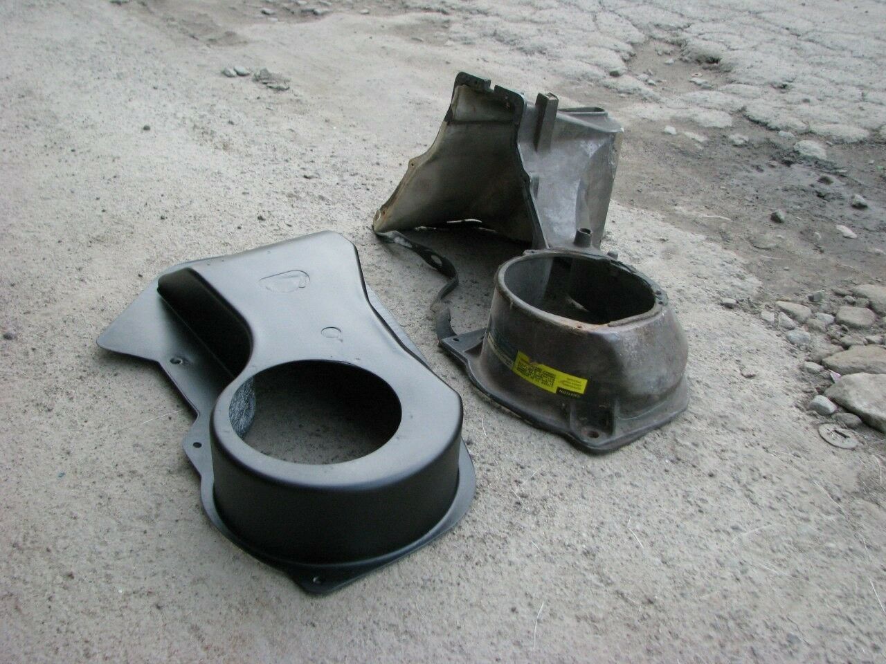

Here is a photo of what the original AC box looked like from eBay
AC delete box. (for non AC motor)

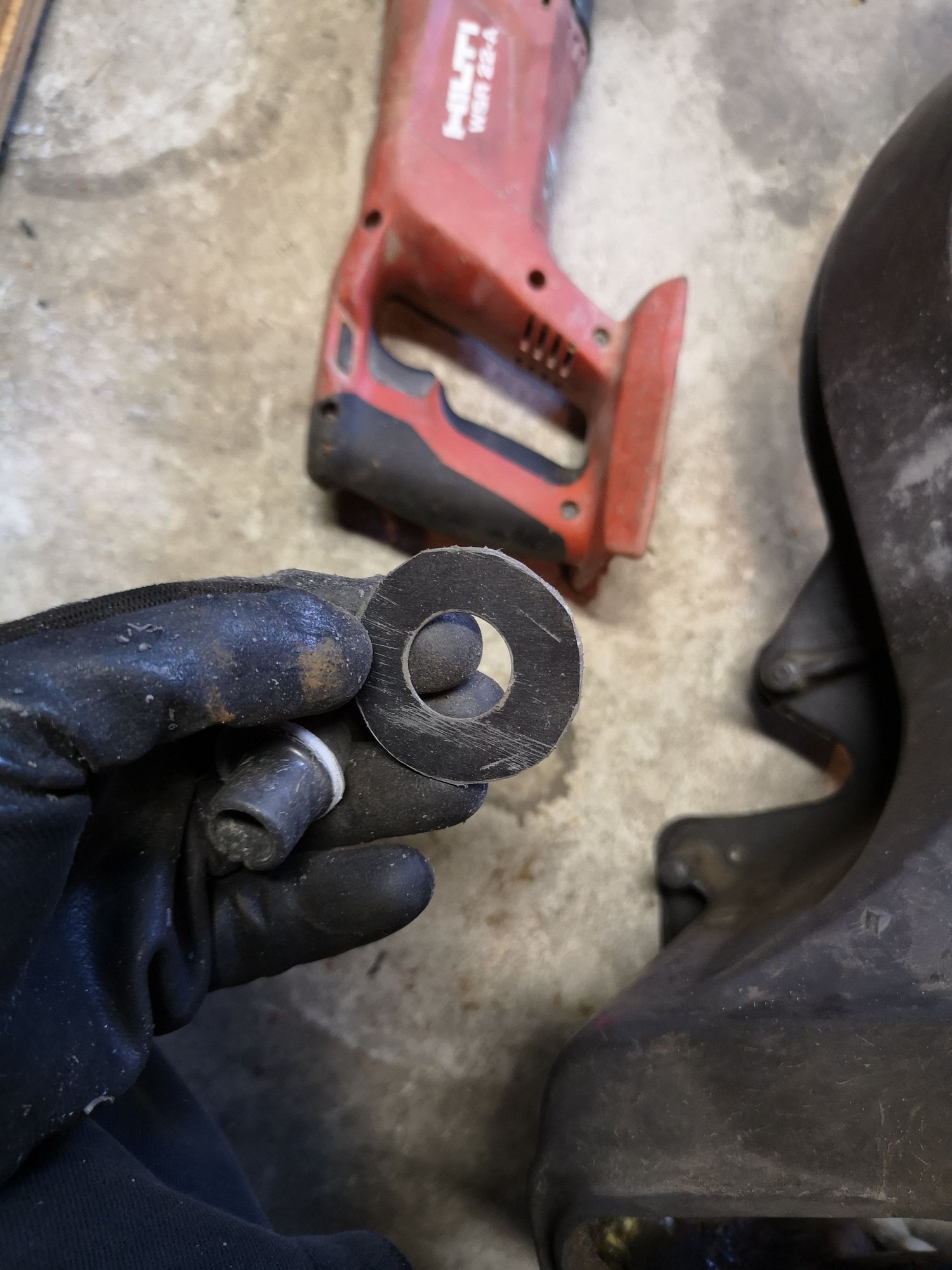

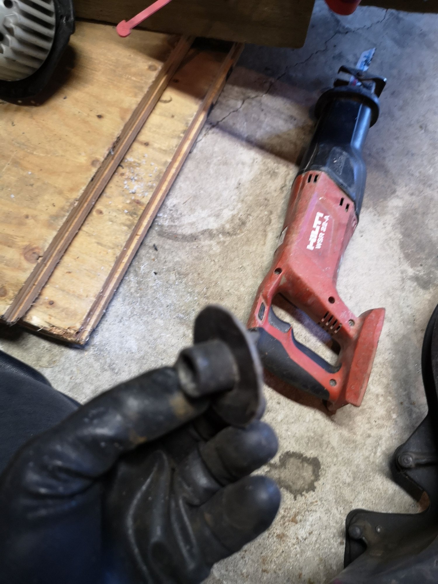

Now you are going to have to unscrew the 4 prong relay then simply cut a square on your new box and attach it. Also, cut out the bung that is for the rubber hose on the front of the motor and cut a hole for it on your new box.
For the bung i cut a bigger circle piece out of the old Box and punched a center hole then jb weld it together.
Next step would be to obviously Jb weld that now to your new box.
