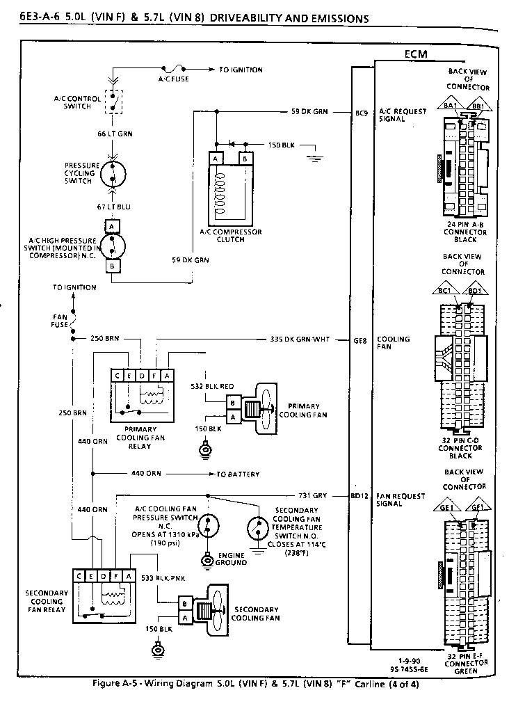

The first image is of your ecm and primary fan wiring.
the second is of 90-92 and shows a second relay for secondary fan.
you should run duel relays and can have ecm control both.

Sorry pictures uploaded out of order yours is the black one.
