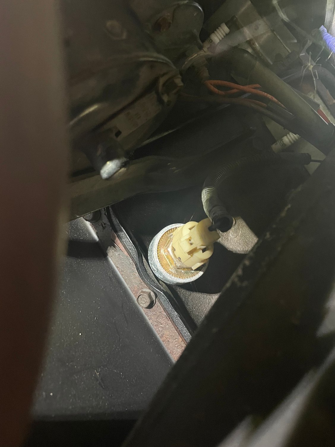

The two drain plugs are on either side of the block in the middle just above the oil pan? Allen head plugs?
Also, What's a preferred flushing technique? I read this and it's great but also really confusing. Nobody talks about engine block drain plugs but it makes a lot of sense getting that crap out right there.

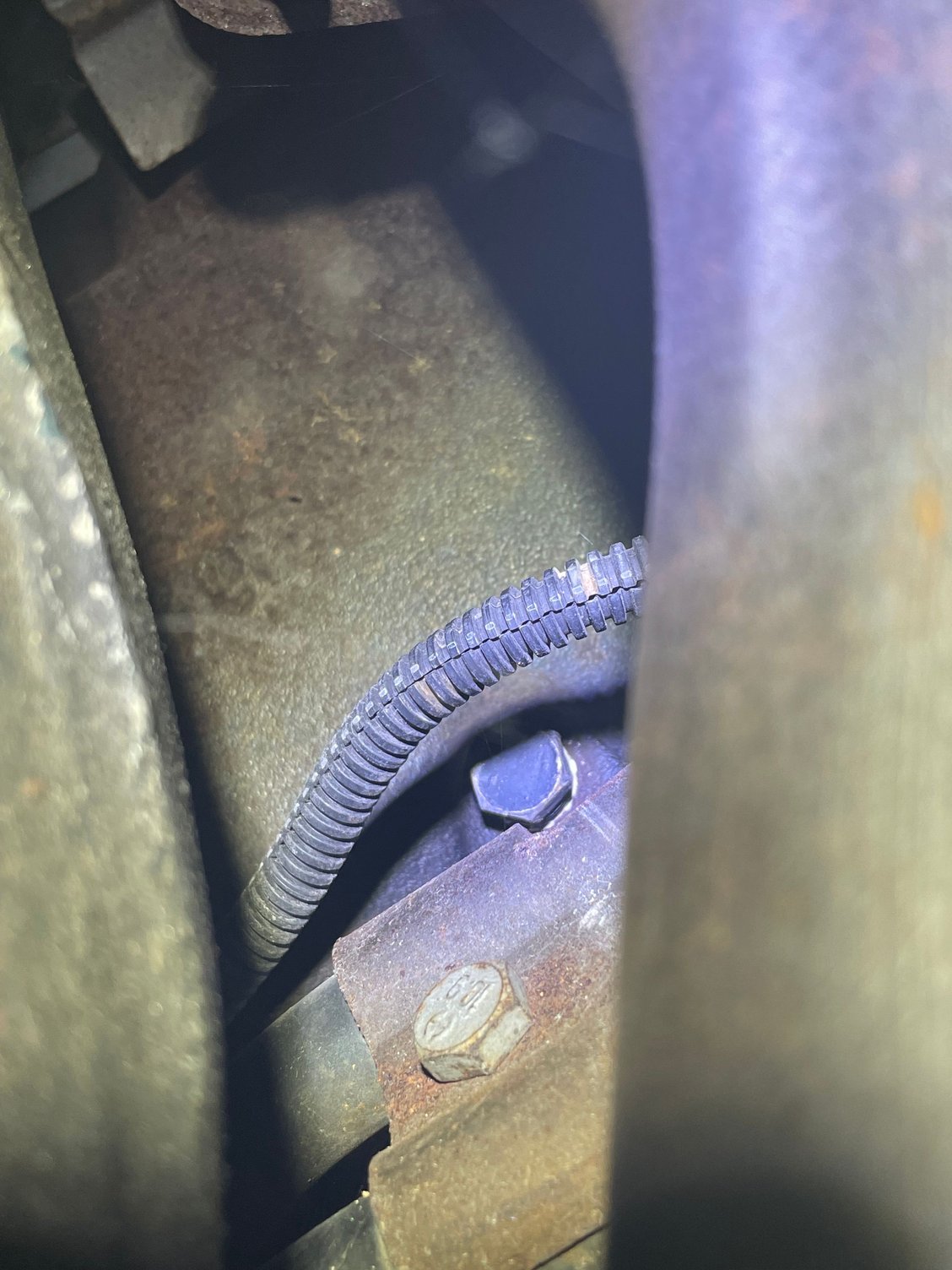

Re: Why is does my new green coolant keep getting brown?
The only way to properly flush is to remove the knock sensor ( pass side of equipped ) and the block plug on the drivers side. On more then 1 (old) engine,...... I've removed the plug and the crap in the block was so thick nothing came out till I used a small screwdriver to poke a hole in the crud,... then it all drained out.
If you don't pull the plugs out,..... your never really going to get the "heavy" crud out; it will just sit at the bottom of the block on each side.
I replaced the knock sensor as one of the first things I did when I got the car in 2017. I took the old one out and didn't know that it was a plug for the cooling passages. I routinely started to clean the gunk out before installing the new one and got a face full of coolant. Reminded me of numerous Three Stooges or Laurel and Hardy scenes, Lol,

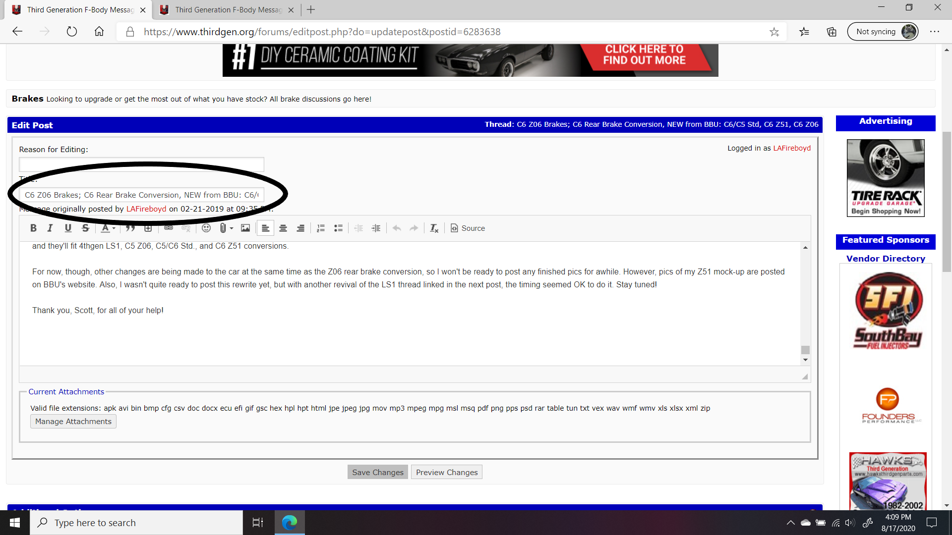

Sorry for D- in grammar. I can't edit it once its up and I have been in the sun for hours today.
Ah, but you can.
Click "edit," the way you'd do it anytime you want to edit, as in the screenshot below:
Then click "go advanced," within the post's window, at the bottom, as in this screenshot:
That changes the window to this window, where you can still edit everything as normal, but including the title too, as in this screenshot:
Then "save changes," as you'd normally do it.

as mentioned in the thread, one is the Knock sensor in front of the starter on the passenger side, and the other one on the drivers side (mine is a hex bolt). I happen to be under my car already so I took a pic of each for you. A large catch pan is recommended as someone who has flushed their block from the t-stat housing it does work well.
