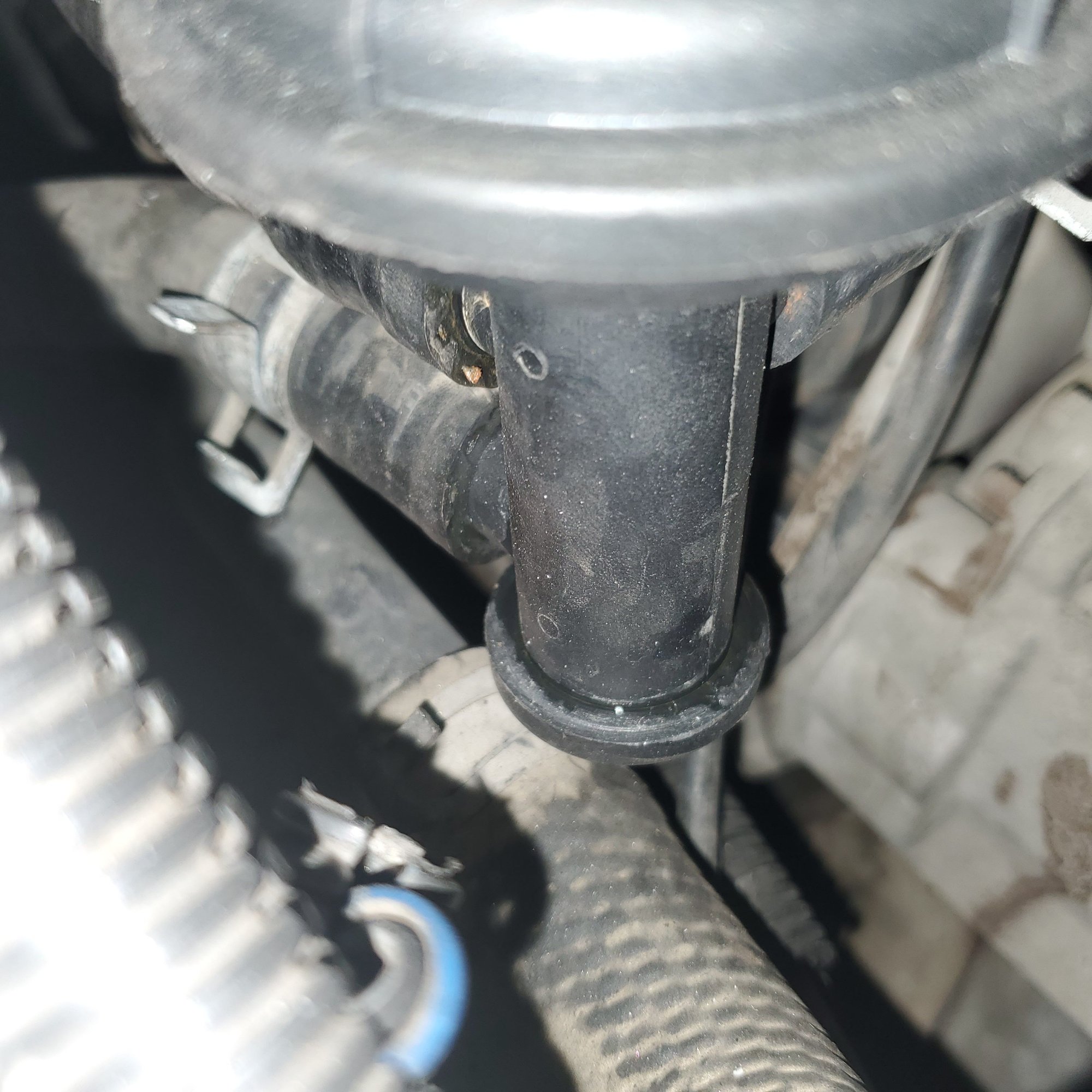

Hi, I hope I'm posting this in the right place. I am hoping to get some help identifying a leak. Recent history is I replaced my cracked radiator with a brand new one I ordered from AutoZone and had put in by a local shop. Everything seemed ok for about 3 weeks but i have only driven it a handful of times due to not being much to do with pandemic going on. Then the last time I drove it, as soon as I got on the freeway, and only a couple miles from my house, I noticed the temperature gauge went all the way up. I got off at the next exit, popped the hood and saw the reserve tank was empty so I checked the radiator and it was empty as well. It was late at night and neither gas station at the exit had any coolant or water machines working. So I put some water from the restroom in and went one more exit to my destination. It was there that I discovered my a/c compressor had seized up and serpentine belt snapped. I got a shorter belt from AutoZone and put it on bypassing the compressor and added some more water. When I started it up water started spraying out my heater control valve so I went back to AutoZone, bought a new one and put it on myself. When I started it again there was some smoke coming from the drivers side up up by the firewall so I ended up having AAA tow it to my house because all of this was going on in a casino pkng lot. I left the car alone for the past week before today when I was planning to put the proper coolant/distilled water mix to the right level and see what it was doing. First I decided to look under the car and found it was leaking new looking yellow coolant (had not put anything but water in since discovering empty radiator due to broken heater valve) under car. I stuck my phone under the car and took some pics trying to see where the coolant is coming from then popped the hood and checked heater valve. It looks like there is coolant around the base part of the heater valve? Could it be defective or maybe I did something wrong when putting it on? I replaced it once before a few years ago and it was okay. I will now try to add some of the pics I took. Any help or insight would be greatly appreciated!! I have more pics from under car but not exactly sure what they are of because i was kind of blindly aiming camera up at arms length from where puddle started. Can share them if I get anyone willing to help. I don't have alot of mechanical experience but I am LEARNING thanks to getting tired of getting ripped off by shops fixing everything but the problem and hundreds of hours of reading on this site. Not to mention that when you're a girl with a sportscar, a lot of guys are suddenly mechanics, NOT lol. Thank you so much for this site and all I have learned here!! Tatiana

Welcome to the boards Tatiana. That's a cool car. Love the T-Tops. Those heater valves are fragile. In my experience they can break while the car overheated (even though they didn't cause it). They are an easy fix and not too expensive. Your leak is yellow because you still had a decent amount of coolant in the engine when you added the water so you will still have a yellowish color from the mix. Treat the new valve gently when you put it in. The hose clamps should be tight but not crazy tight.

Hi, Thanks for the quick reply! That pic is the new heater valve. Did I break it putting it on? The one I replaced had the whole outlet, that one of the hoses attaches to, broken off clean. Is this brand new one in fact already cracked too? without driving the car?? I put this new one on immediately before having it towed home. It has been parked ever since. Only started it to turn around facing my house/garage because the tow truck backed it in driveway. Thank you again!

Make sure all your hose clamps are on all the way on your heater valve. From the picture, it looks like one is not on all the way, but i can't tell for sure.
Even if the hose clamps are all on, you may still have a leak at the hose connection to the valve. The heater hoses can dry out and get less flexible over time, which can cause a leak in spite of a solid hose clamp connection. Might need to replace your heater hoses too, which is not a big deal.

Thank you guys so much for the votes of confidence!! I got the heater valve clamps on properly, no more coolant leak and it was running steady at 170-175 degrees. I am actually on my way to AutoZone to pick up the Haynes manual I ordered!! I don't want a boring "practical" car. When any of my family or friends with new Toyotas or Hondas and even a brand new mustang suggest my car is an old POS, I say "oh yeah? when was the last time you were at a red light or gas station and someone said 'nice car', 'what year is that?' lol. I even had someone ask to take a pic of it the other day. So with the help of you guys on here and my new Haynes manual I am going to try to work on it myself. I have gotten pretty good at the diagnostic part just from reading, now its time for some hands on work!! Thanks again for your help. Which brings me to this question...I had some issues with a no start a couple times over the last few days, wouldn't jump start, put fuel right into the air intake and it started right up but the heater motor plug wires started smoking so i disconnected it and it was fine. It did the no start thing again and I found a couple wires i needed to splice back together and got it started. I could go on and on about each incident but my diagnosis is a bad ground or short hence the instrument panel, headlight issues, etc and things seeming to fix themselves but something new starts happening. I have known I have a vacuum leak but now I went thru a tank of gas in less than 100 miles. I will get the new hosing and attempt to repair it. My question is...is this the proper thread to get help with these other issues? or do i need to start over in a thread that covers the specific topic i'm working on? is there anywhere I can post my progress/problems now that I have embarked on what will be a new and ongoing saga for me? Is it inappropriate to think anyone wants to hear it? Be honest, if you guys don't have time for a newbies drama, just say so. LASTLY lol, relevant to this thread i want to ask are there basically just two sizes of rubber hoses? i mean the bigger heater, radiator type hose and the smaller vacuum hoses. or are there multiple sizes of hoses?
