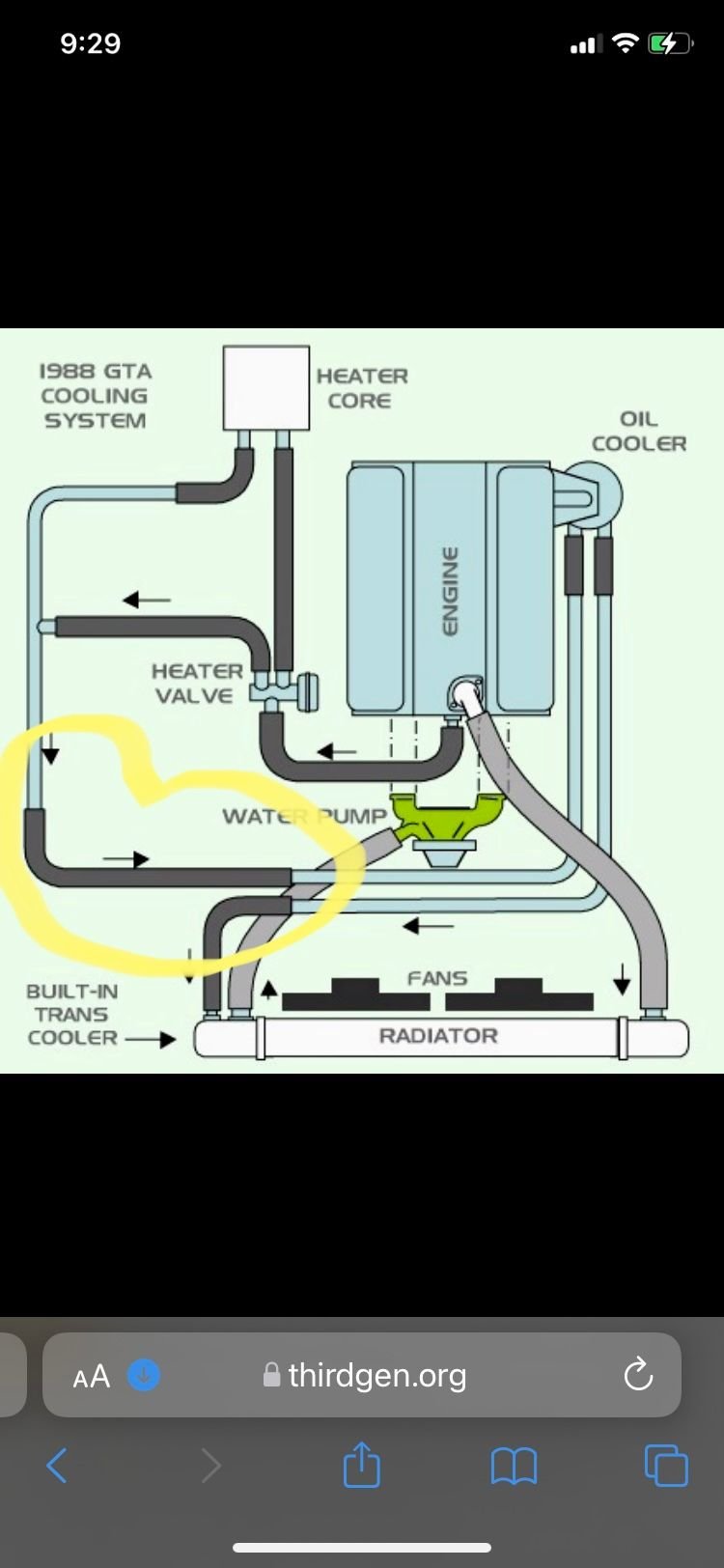

Oil cooler hose. Anyone have a part number for that hose. Thanks in advance.

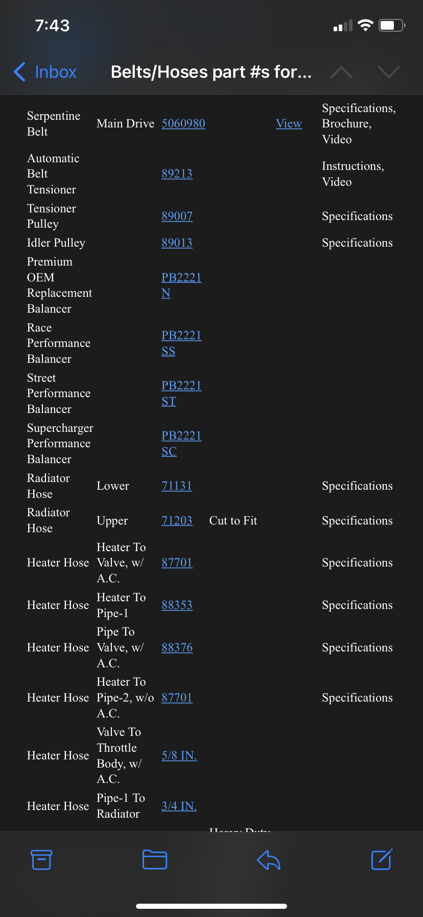

Re: Oil cooler hose. Anyone have a part number for that hose. Thanks in advance.
This might help, I believe this is for Dayco hoses. I believe for that one in particular I took the original to O’Reillys and found one in the back that was close and trimmed it to fit perfect.

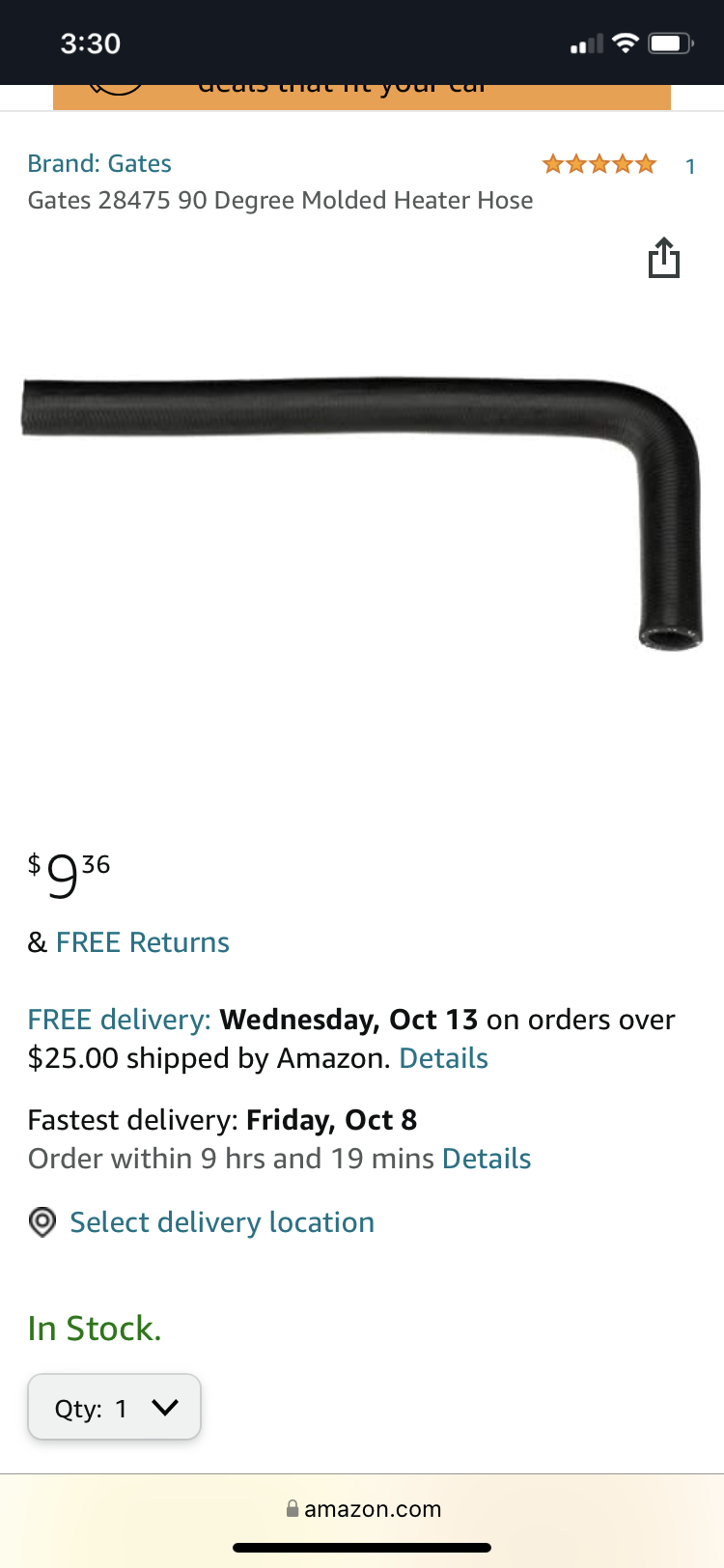

The bulk hose just pinches to much in the tight radius. So I ended up using the Gates 28475 90 Degree molded heater hose. I little trimming and it a perfect fit.
